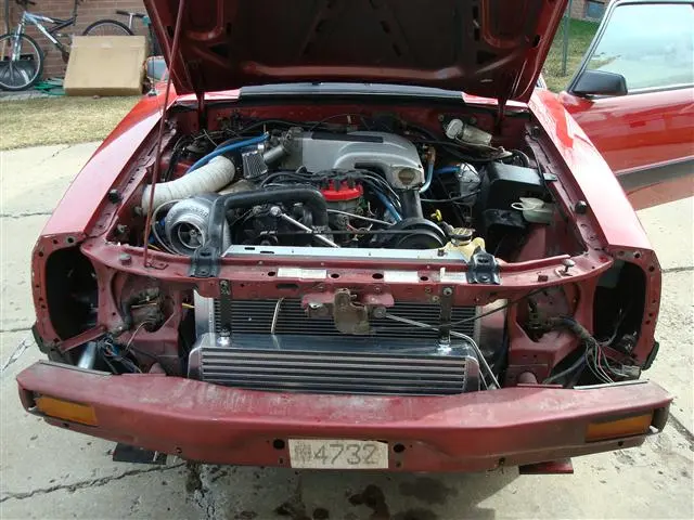

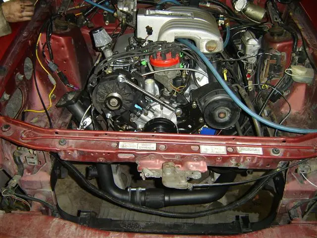

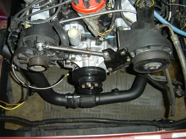

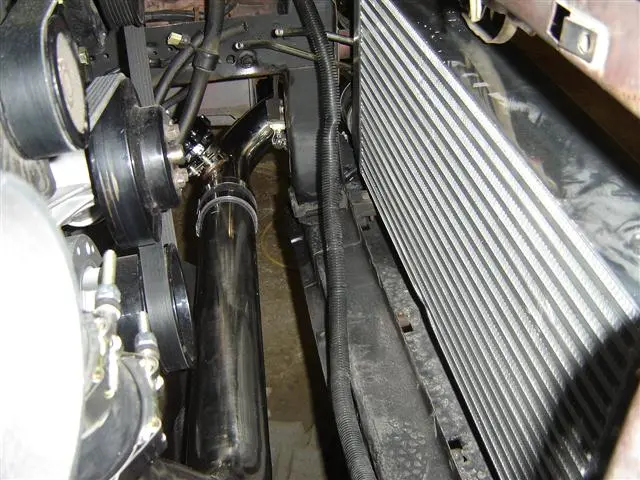

Wait what? no way? OP do you have some different angles of the turbo piping? I was under the impression you needed to swap kmembers. I was going to pull the trigger in the fall on a vortech sci trim, but eff that for the same price i'd rather go turbo!
sure, see attached pics below. also the whole kit only cost $1800
What kind of gauge is the one on the very right? Tell me that's not your wideband it was bouncing all over the place!
no, its just the camera. the frequency is similar to the update rate of the wideband, so it looks like its flashing on the camera. kinda like video taping the TV. It was in the 11s the whole way down :)
