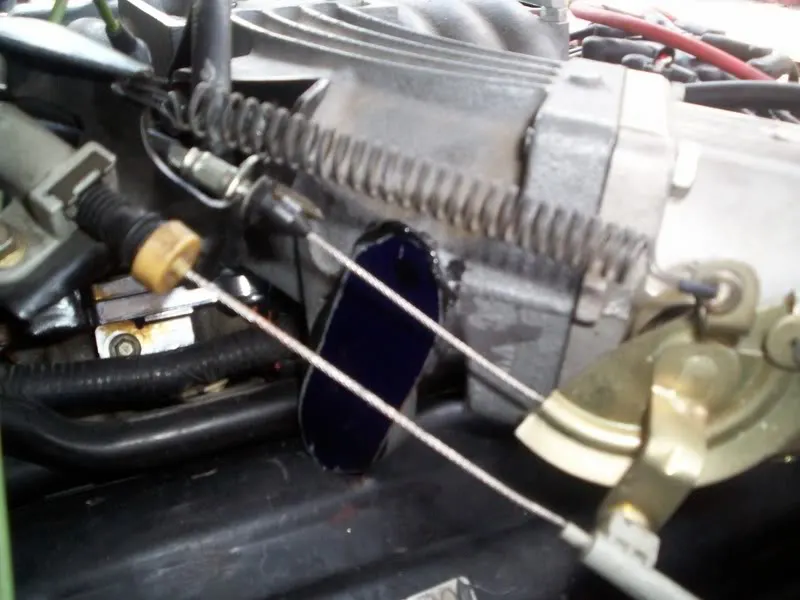

my egr is also deleted. I get 3 codes regarding the egr when I do the KOER test(obd1)
I was told this is hurting me, but I was also told it doesn't hurt performance.
The previous owner had the side of the TB sealed and the header capped. Do I have to buy something if I want to put the egr back??? here is a picture of how it is sealed.

Do you get a Check Engine Light? If not they pulled the bulb, or rigged the sensor.
You have to leave the sensor on a stock car, and push the plunger halfway down to get the CEL to go out.
My car ran better after removing the EGR. Mine was sticking.
I've had both the 94vert all the way torn down and a 1995 Cobra. let's hook up and let me take a look at your ride. I could show you a few things and see if everything is on the up and up.
