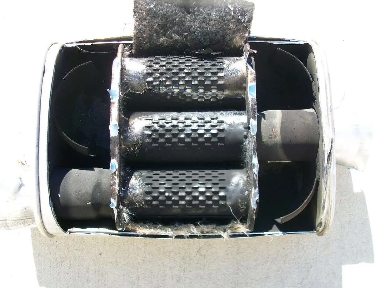

An electric cutout is not louder, it's the best of both worlds. Unrestricted flow past the headers while open, or when closed exhaust is routed through potentially extremely quiet mufflers, regardless of the backpressure they would impose. I suppose if you aren't worried about power and don't want cutouts, OEM mufflers would be your best bet. As mentioned, super turbos didn't quell the drone as much as I'd hoped in my application despite the fact that they are well-known to be 'quiet', and my research suggests that the internal pipes still constrict down to no larger than 2.5" in diameter, despite the inlet and outlet diameter. On high-powered cars, it stands to reason that they'd be restrictive. On my car, when I revisit taming the noise, I probably will look for OEM mufflers, though not necessarily fox OEM. One unfortunate limitation for us is restricted space under the body for mufflers. So, they have to be shorter than most cars.
This isn't the offset-offset version you'd need, but you get the idea & can see out the inlet & outlet immediately constrict, followed by more constriction in the internal tubes:
I think i'm beyond messing with any more custom ideas for the exhaust. Right now it's easy to take apart and reinstall.
Any muffler that won't be a direct fit is probably off the list for me.
That probably leaves me with super turbo's and maybe a couple others. I don't think i'm going to experiment with it during the summer and if it doesn't bother me going into winter, i'll just leave it. I tend to create problems to fix.
