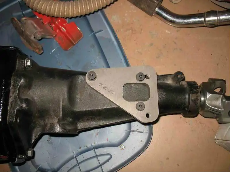

The steel bracket shown in the following link will move the shifter back more to the rear: http://www.summitracing.com/parts/HUU-1956834/
The bracket is shown from the transmission side and it mounts the shifter toward its rear (the left hand of the photo.) It is made of steel.
Not sure if it will work in your application as it is normally used in a BB 67-69 Mustang, which also use the center of the tail housing for mounting--like I assume yours is. This bracket will move the shifter 1" more forward than the aluminum bracket location (when it is properly mounted in the rear.)

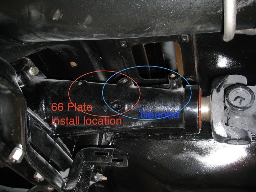

Thanks for the find! If you could check for fitment, that would be great. Below, the red oval shows where the hurst 66 mustang plate bolts to and the blue oval shows where I believe I need a plate to bolt to in order for the shifter to fit correctly.
Tomorrow I'll measure how far off the shifter is to see if 1 inch is enough or if I need a plate to mount on the rear most mounts.

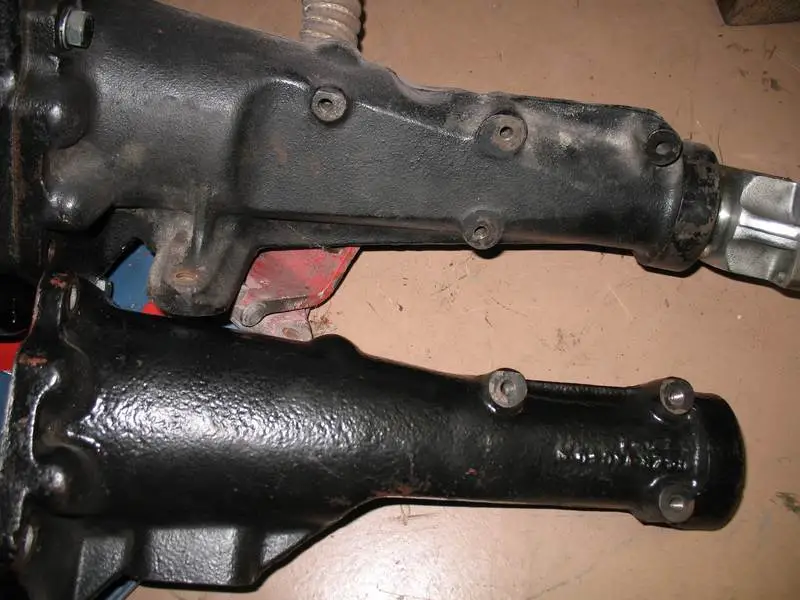

In the following pic, I show the same D0 tail housing as you have on the top and the correct C4 housing for your car on the bottom:
Here is the bracket in question mounted on the front set of mounting holes:
Note that the shifter bolt holes are located to the rear by 5/8" center to center from the mounting bolts.

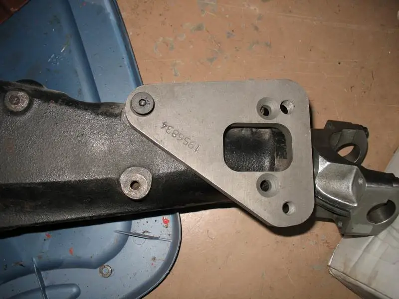

The same bracket bolts to the rear of the early housing:

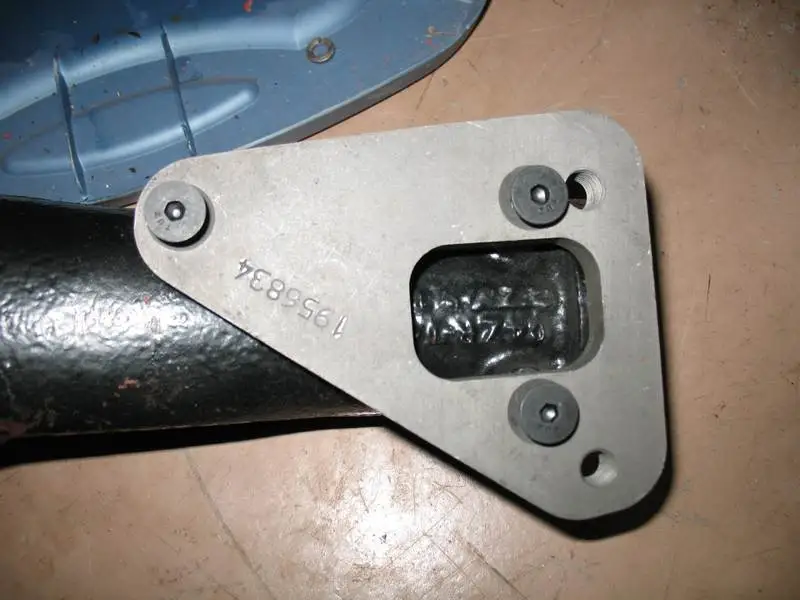

It will not bolt onto the rear of the late housing as none of the bolt holes will line up:
The bracket I am showing is the one for a 67-69 big block Mustang as for some reason the forward mounting location was used. Here is what it looks like:

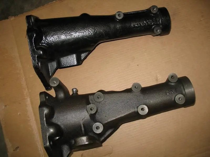

My aftermarket tail housing that allows me to use either shifter mount (and others) is below the C4 housing at the top:
