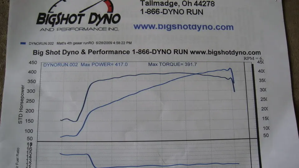

Well boys and girls, the moment you all been waiting for. Finally gonna let you know the results, but before we get into that, just wanna say....WOW! it feels like a whole new car now. It was raining all day and sprinkling on the way home so the roads were still wet so I couldn't really get into it, but for the little bit that I did, it was an instant woody :).....and the sound :drool:
Now, without further ado.......................

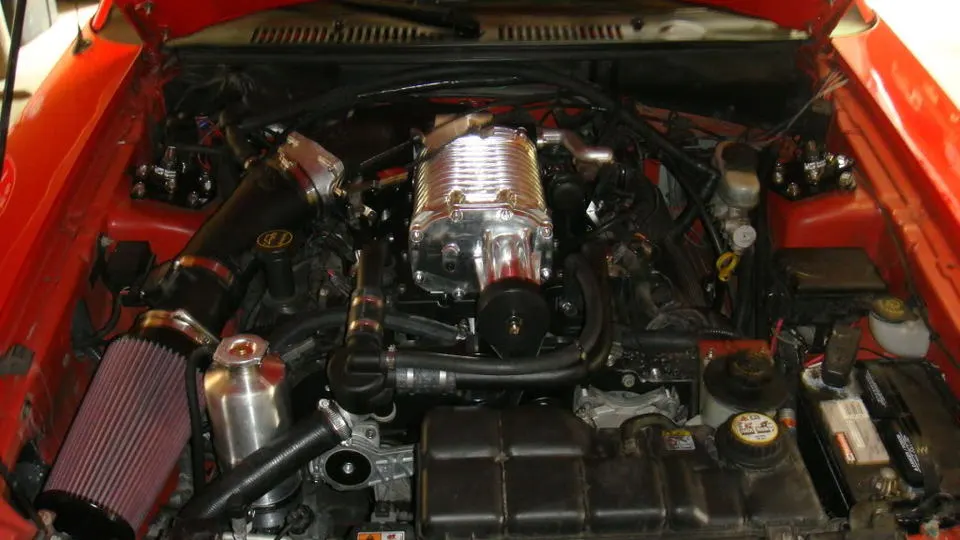

417 RWHP/391 RWTQ :banana:
Defiantly better than what I thought it was gonna be. It did hit about 10.5 psi up around 6000 rpm :nice: The tune that Tork Tech sent was a little off. The timing they had really high. Keith at BigShotDyno used there tune and just adjusted the air/fuel and set the timing back some and it was good to go.

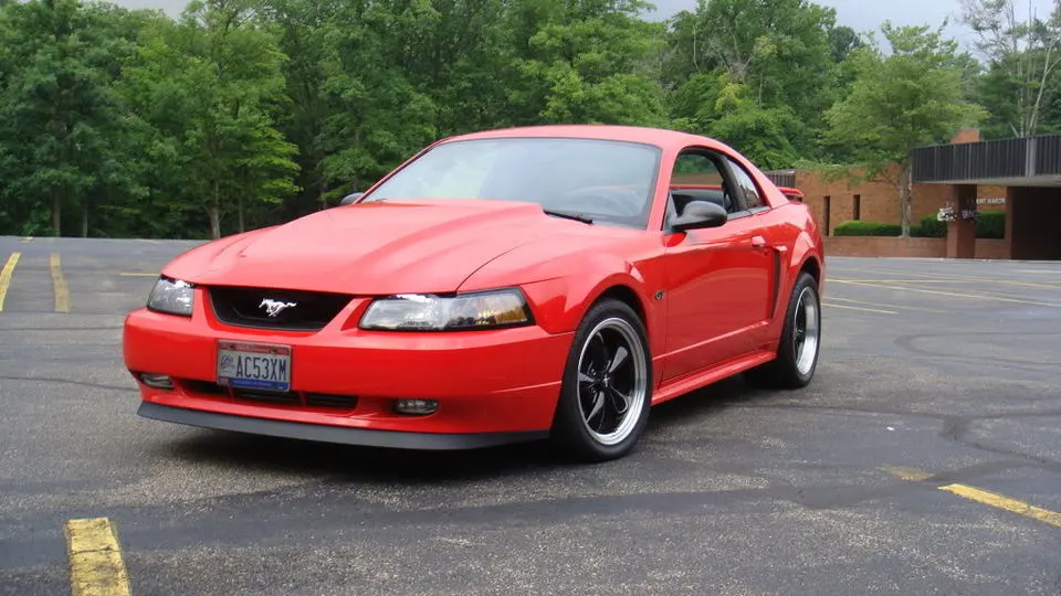

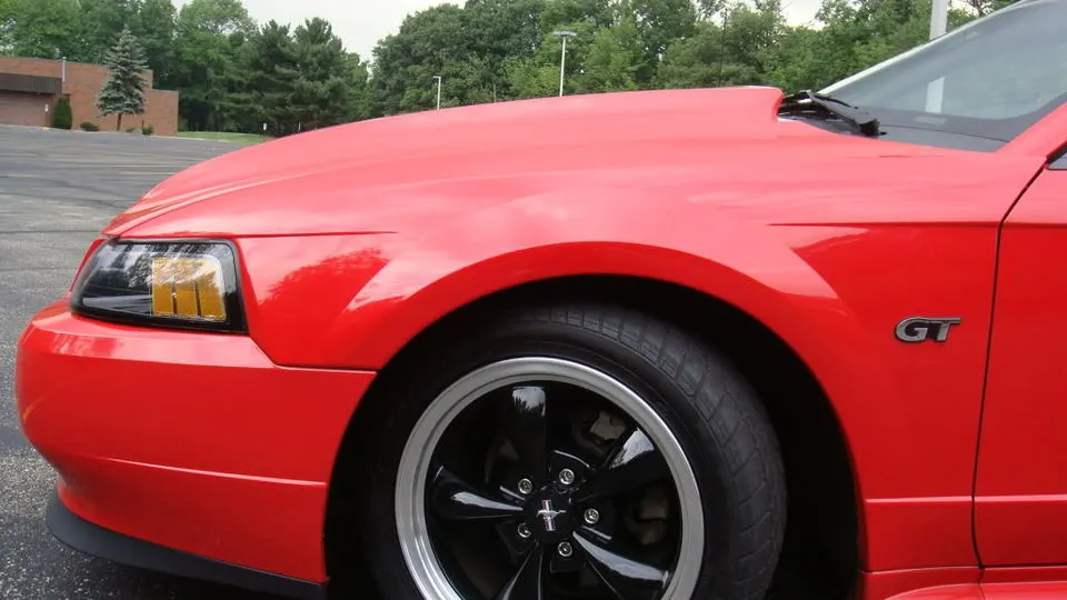

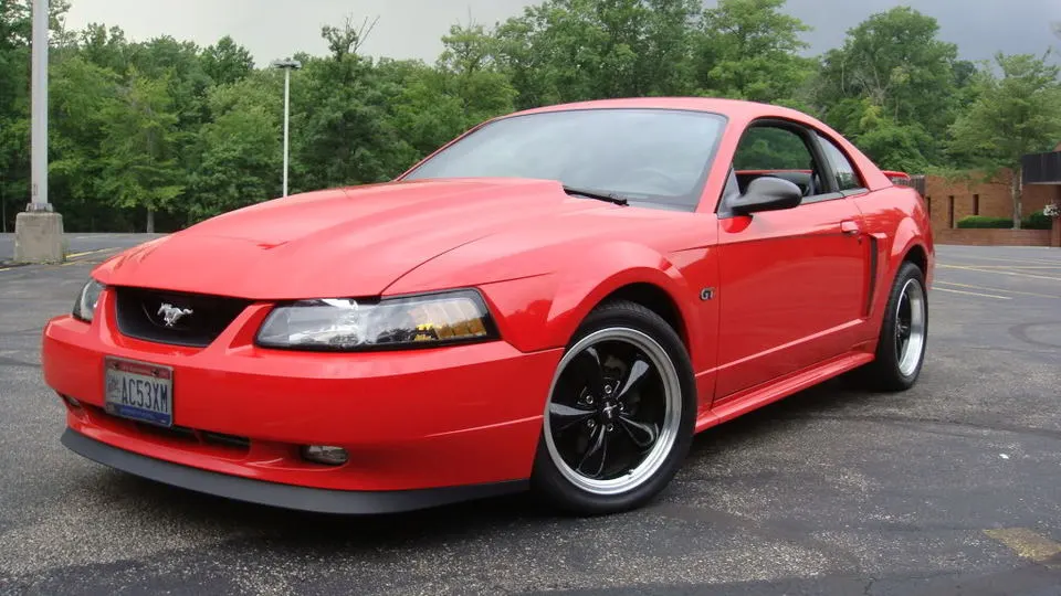

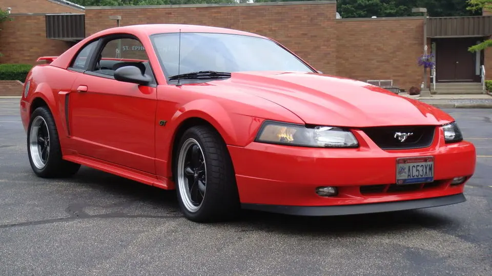

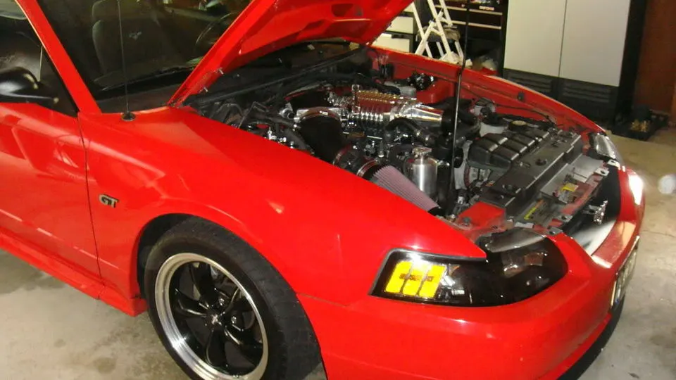

Now some quick pics of the new hood and springs, and a short video I took(the rain was coming.....AGAIN :() and I know, I need to clean the rest of the engine bay now :D
Not sure why it sits higher in the back, suppose to be 2" all way around :shrug:

Look at that fuel curve...or lack of a curve. Have you thought about a small 50-75 shot of nitrous for it?

Very nice! It looks like a nice broad tq curve! The new hood looks good too! I wouldn't worry about the rear being higher, the springs will settle some over the next few days. What springs did you get installed BTW?
Thanks. The car been sittin about 4 days now on the new springs.....hopefully it will drop a bit more. They are Hotchkis springs.

sweet! what fuel pump and injectors do you have? how much fuel pressure do you see on that gauge at WOT?
Fuel pump is an SVT focus with 42lb injectors. Both come with the kit. I don't have my fuel gauge hooked up yet. Need to figure out how to. :( My fuelrails have no schrader valve on them and I had gotten two differnt adapters that go on the fuel pressure sensor but one, the screws hit the rails and you can't tighten them and the other it hits the blower....so :shrug:

I would say nice torque curve but its more of a shelf! :nice:

nice numbers, but more important... nice torque curve! damn that thing is nearly flat-lined from the time you come into boost.
speaking of... how much boost are you seeing, and at what rpms? i'm running a centrifugal blower and contemplating a switch to a roots/tvs/twin-screw because of the nearly instant low-rpm boost levels i keep hearing about.

Don't worry about the springs. 9 times out of 10 the rear will sit lower than the front. They will settle over the next month or two and you'll be happy! :D

Like I said, I haven't really gotten into her yet because of rain :fuss: When it was dynoed, he seen it go to 10.5 psi at about 6k, pretty much got 8psi right off the bat :nice:
