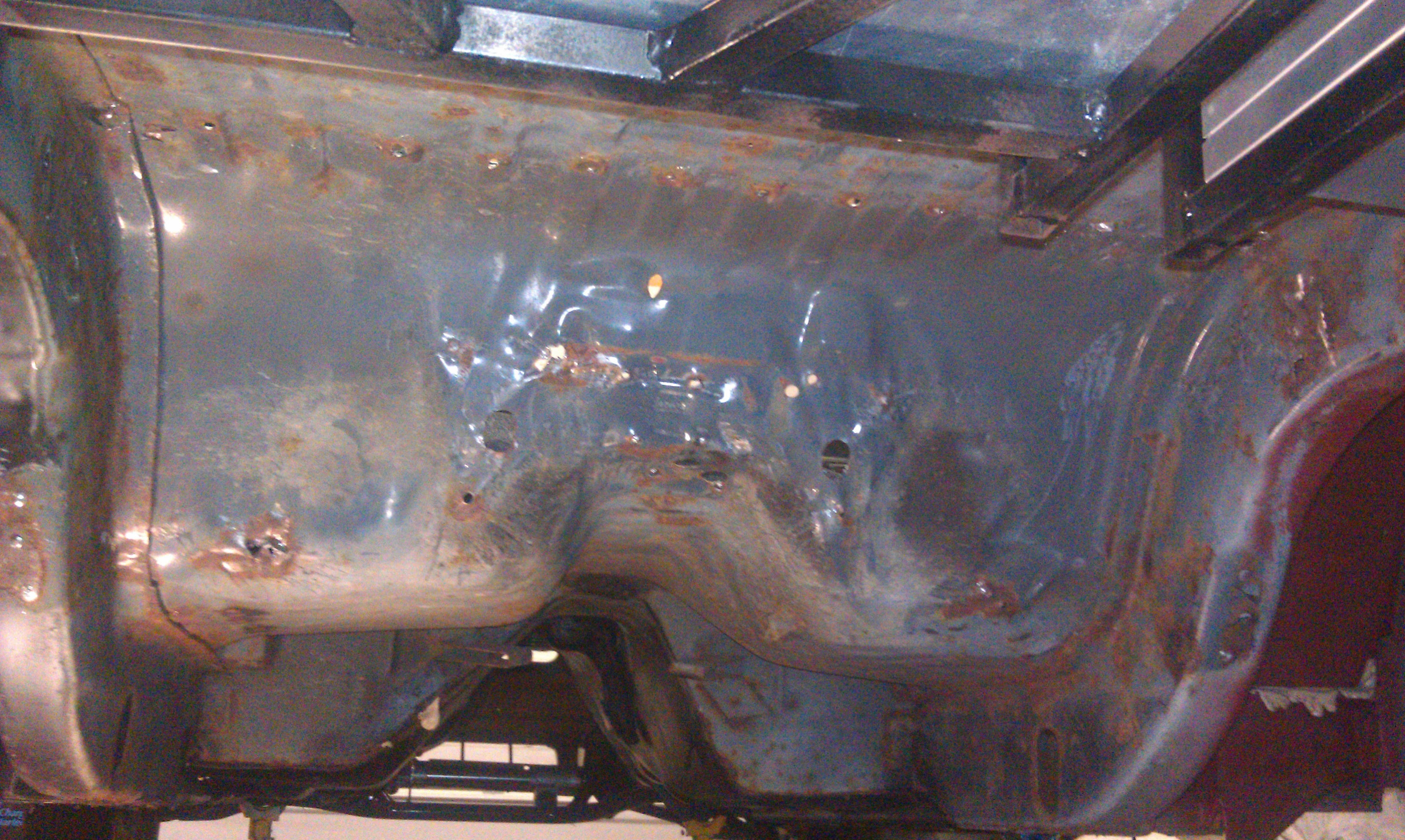

They have been breaking from general street use. I have had 2 pro welders try fix them then i tried myself and still break. And the problem is as well is that no one here has been able to push them back into their proper places and with them welded my axle was sitting off center. So im not even considering fixing them i want to get rid of them once and for all

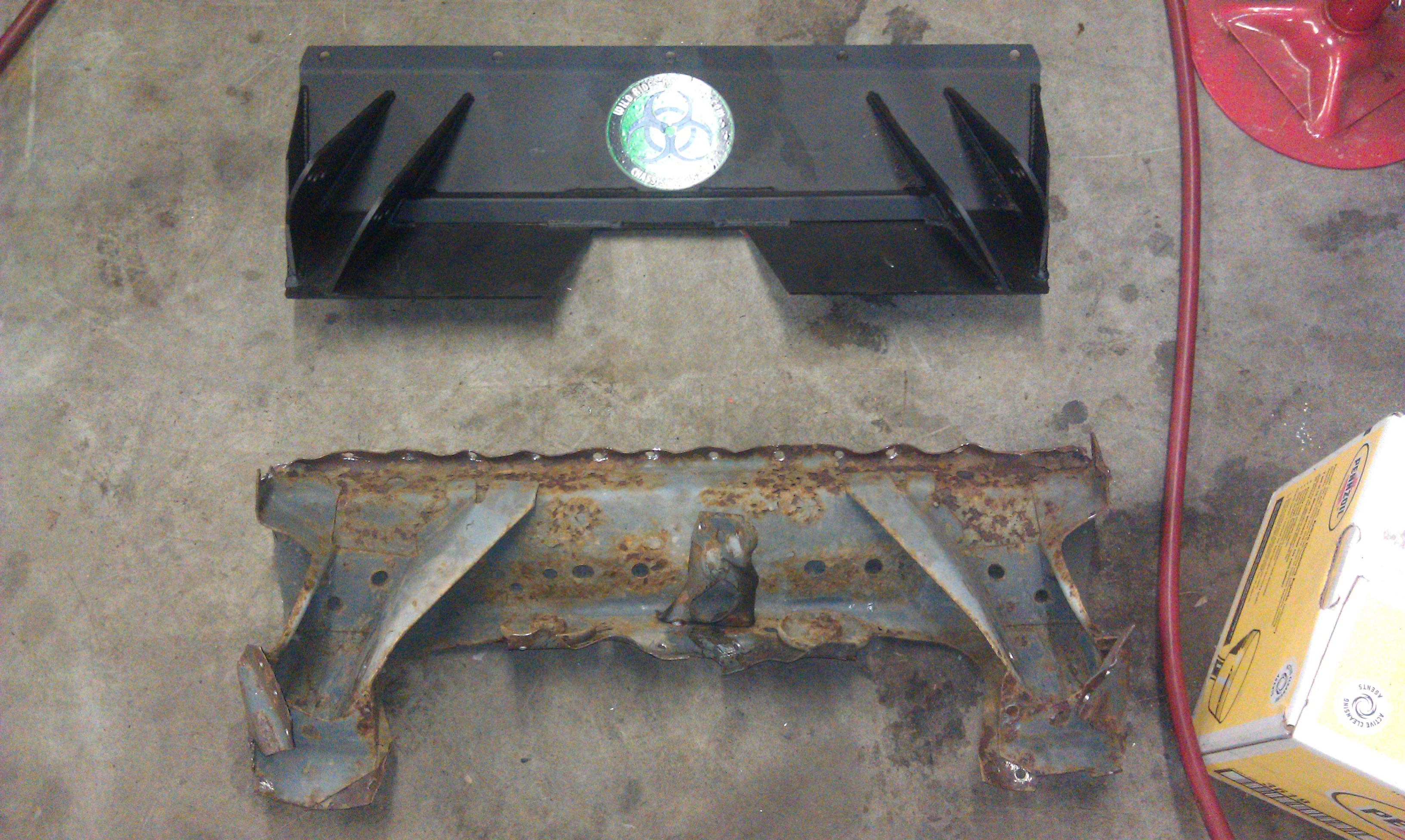

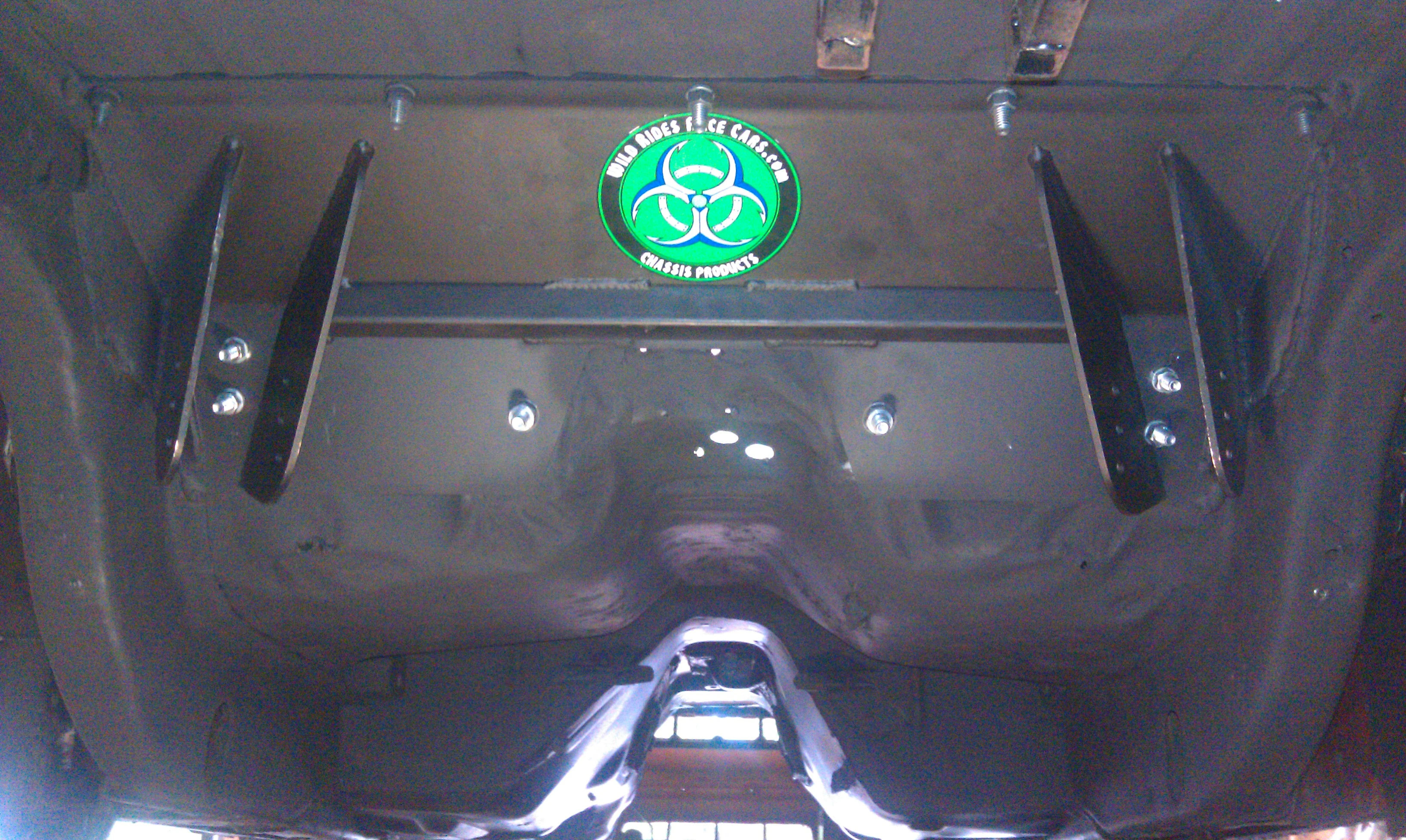

This isn't an accusation but an observation... I think maybe you needed to ask questions LONG before you got to this point. Wore out from general street use, my Aunt Fanny. An improper use and/or combination of control arms and control arm bushings are what is usually responsible for torque box breakage. Suspension bind induced by street driving and an incorrectly assembled 4-link.
The purpose of my saying all of that is so you don't get this all fixed up and end up right back where you are. I'm with 84TTop in thinking that a torque arm is not what you need. What you need is a properly setup 4-link.
The immediate concern though, is getting your upper torque boxes CORRECTLY repaired and aligned. This is a good place to start:
http://rover.ebay.com/rover/1/711-5...0001&campid=5335821607&icep_item=321027220491
BTW... I tried once having a 'professional welder' make me a cake. It wasn't very good. Find yourself someone that KNOWS SUSPENSIONS to get that torque box replacement properly installed.
Here is my fix to that problem, Exactly this ^^^

i live in the bahamas so there is no one who really knows how to fix it. the replacement there actually looks great. i didnt know that you could get those. thanks sooooooo much for the help guys really appreciate it i think i will go with that replacement for sure. i think ill change out my control arms same time. what do you guys suggest to put in? i definitely want adjustable lowers but what brand should i go with?

i sadly dont have any pics but they pull away from the main frame rails on the sides and the cross plate cracks
