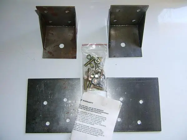

I had problems with my torque boxes on my fox mustang. I bought a couple of kits to fix the problem and still have one for sale.
It includes everything pictured, and installation instructions.
Let me know if anyone needs these...
Posted 5 diffrent threads that are at least 3 months old just to sell something you bought

I need to get rid of these before I leave town for a few months so I hit up the related threads because the people browsing those threads are obviously interested in torque box reinforcement kits. Makes sense to me...
