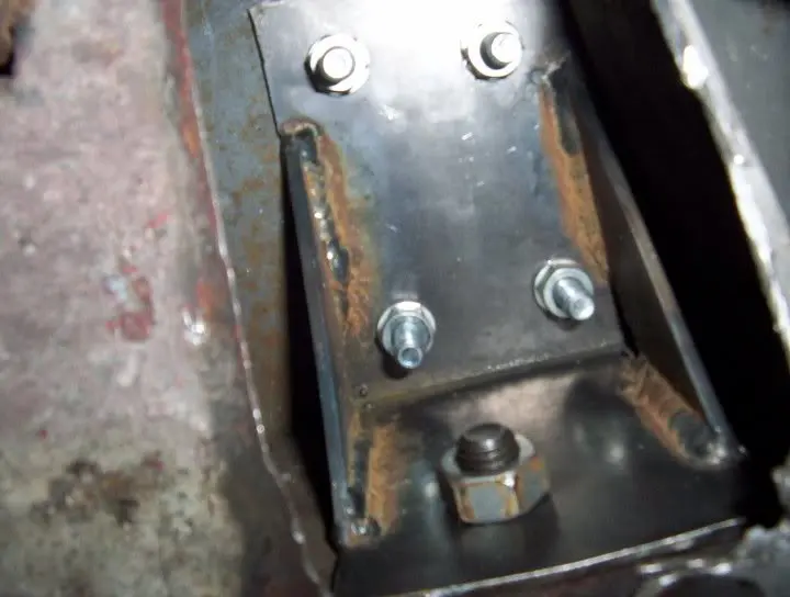

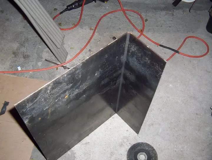

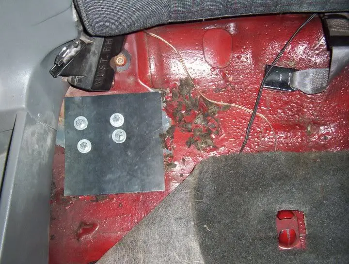

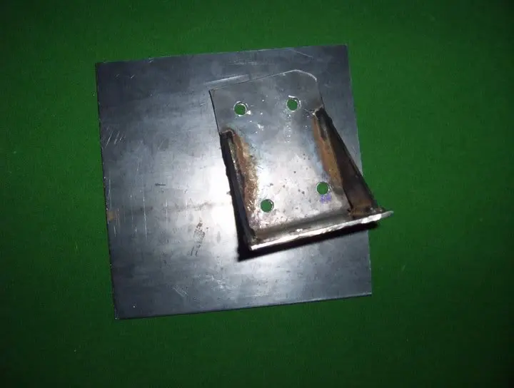

i made my own.... cost me a total of $10 for the metal plus the hardware from home depot (like $3) i went down to a local metal place and grabed a peice from their scrap pile and had them bend it to a 90* angle for me then i made them as big as i wanted, i did mine when i did my LCA's since everthing was off the car anyway. all you have to do is fabricate one side then just make an exact copy
fun little project if you like doing this kinda stuff (like me)
peice of sheet metal i started with
off the car
on the car (ignore the rust this was jsut a mock up)
inside the car
i hope thats what your talking about

Your reinforcements look pretty good for home made, but your bolts look like they are Grade 5s, I would stick Grade 8s in there to be safe.
88_GT_5_oh
Sportin' a turbo 5.0 in Canadistan
Jul 4, 2004
WPG/MB/CA
Dec 11, 2006
  • Dec 11, 2006
the bolt that holds the control arm is actually stronger than grade 8 i ordered them through work. the 4 bolts that hold it to the floor are probably grade 5 like you said, but with 4 of them per side i see other stuff breaking before the bolts do
