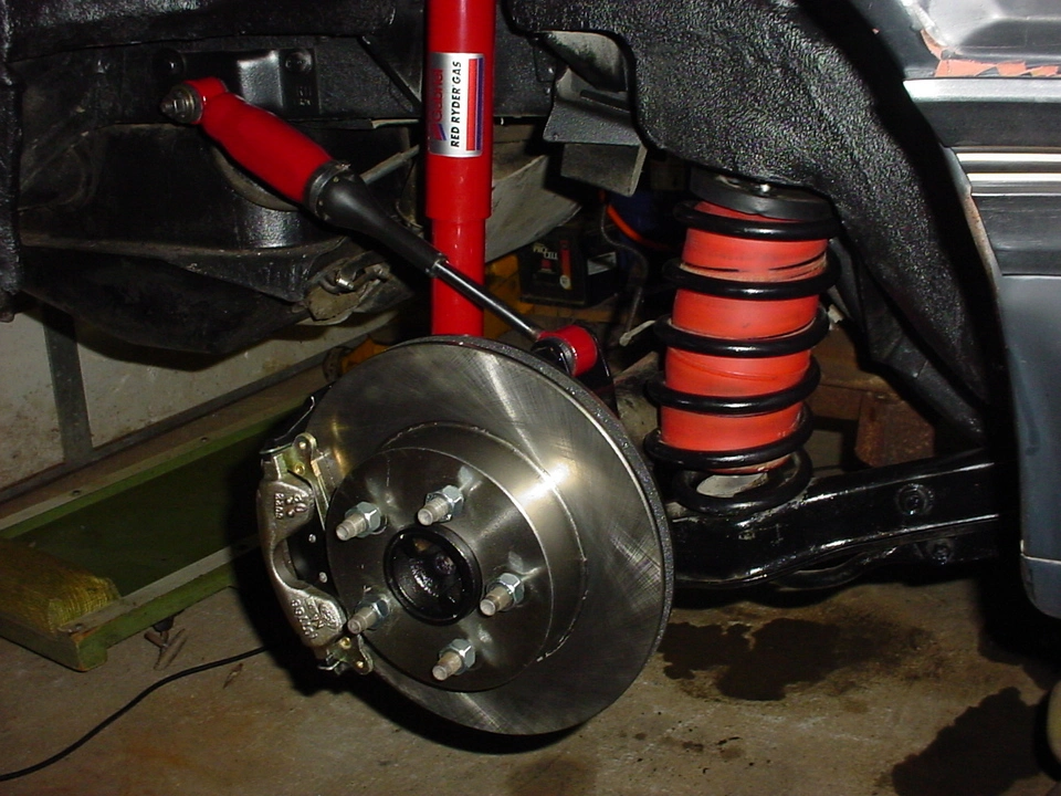

On your rear end, you have two shocks. The vertical one is the normal shock, and the horizontal shock is the quad shocks which helps control wheel hop
R
racing302
Jul 27, 2010
29
Chambly, Qc.
Oct 23, 2010
  • Oct 23, 2010
Wow!
Thanks for the pic 5L5!!
Was that taken on your car?
Any advice on what brand? I see the name on the pic but...
I saw companies selling some metal bracket to be either bolted or welded on tha car to stop the wheel hop...would that be good to install also?
Hey man, greatly appreciate your knowledge and your time!!
