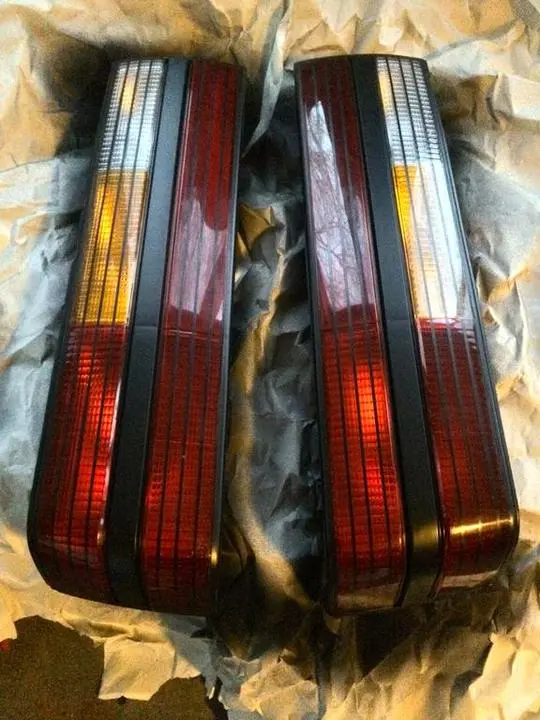

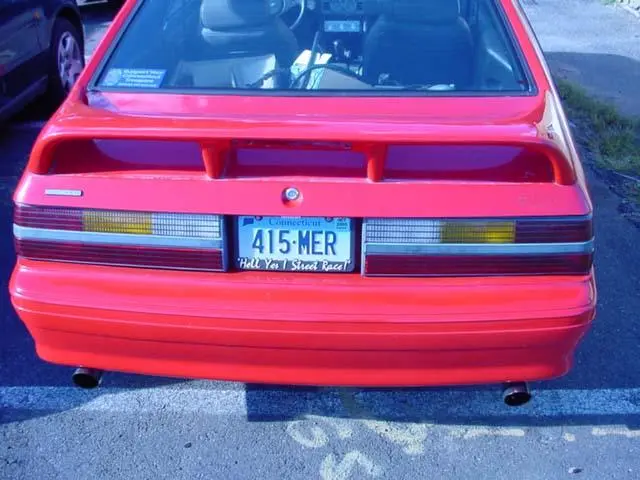

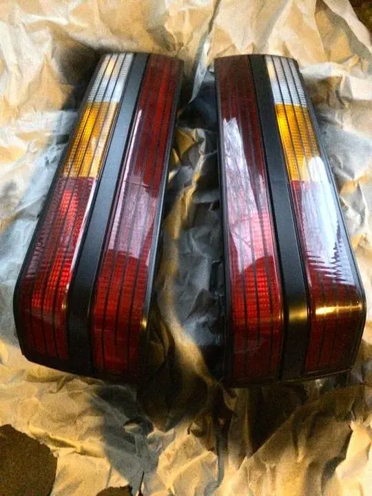

So I wasn't happy with the fading of my 85 GT tail lights I pinstriped to look like dimestore 93 Cobras.
So after looking at the can of SEM trim paint I was going to use on the window moldings, I decided to give it a go. After carefully taping the lights last week, I scuffed them up with a green 3M pad, wiped them down with wax and tar remover, and had at it.
Here is the end result, which I am very happy with. The SEM paint went down a little rough, but it smoothed out perfectly as it dried.
