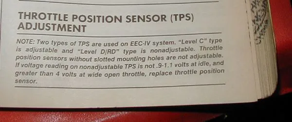

You will never ever find or see anything from Ford that even remotely hints at adjusting that type of TPS.
Ford did have an older style TPS (Level C) that was used mostly with the POS EEC-III's computers. Those "Level C" TPS units had to be adjusted. The EEC-III was such a POS if the temp sensor went bad, or if the wire to the temp sensor broke, then the engine would die. Today, if Ford or another car company had a ECM that did that, they would be sued out of business. When Ford switched to the EEC-IV's they still left the old TB's on some models for a while until the next update of the engine components. Also, until ~1989, Ford had problems making the D/RD TPS units with a proper seal from water. So, they kept using the Level C units until they where sure they could make the new TPS units reliable and also update the all of the needed TB's.
From a Ford dealer Service manual:
http://www.veryuseful.com/mustang/tech/engine/images/tpsAdjustment.jpg
http://www.veryuseful.com/mustang/tech/engine/images/tpsInfo1.pdf
http://www.veryuseful.com/mustang/tech/engine/images/tpsInfo2.pdf
In the second one, notice the note that says that the sensor value may vary by +/-15% due to sensor and Vref variations. As mentioned above in the TPS FAQ, the sensor value changes with age and temp. The Vref changes with temp. All real-life sensors and voltage regulators do that. Component accuracy and "TempCo"'s (Temperature coefficient) are one of the important factors in selecting a specific part.
