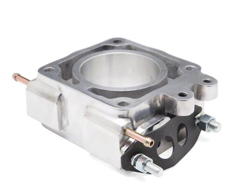

I have a 95 gt. I added a 75 mm throttle body with a compatible air intake. It ran fine for about 100 feet till it started a high idle (2grand). The engine would stay at the rpm and speed that i left it at until I either revved it again or shifted. My tps will not stay at the voltage I set it to. So I replaced it and I'm still having the same problem. It feels like the throttle is getting stuck but only if the tps is plugged in. It runs decent if it's unplugged.if plugged in it won't start or idles high and the above problems persist. Any advice would be greatly appreciated. Local mechanic won't work on it due to being aftermarket parts. So yall are my only hope. Thank you.

The tps and the new throttle body are not jiving, put the original throttle body back on and see if it goes back to normal.

Almost every aftermarket throttle body has a idle bypass adjustment, which the factory throttle body does not. It's a little screw somewhere on the throttle body that adjusts the amount of air that is allowed to bypass the throttle blade. This is used to take load off of the Idle air controller for heavily modified engines. Screw that completely closed and see what happens.

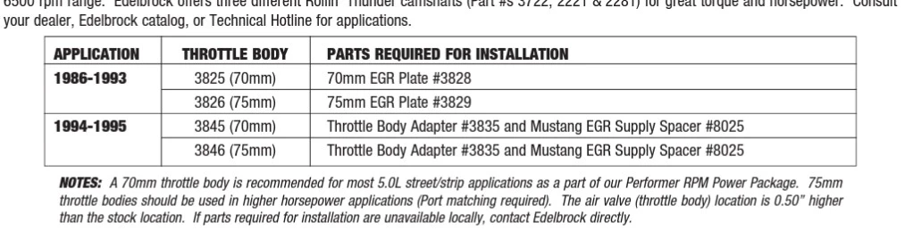

Any headway to the problem?
From what you describe would be classified by me as possible installers error plus too big of a TB unfortunately as when you change the throttlebody to a bigger size you must also put the correct corresponding sized EGR plate to match the larger TB. You should of actually went with a 70mm TB too...
Usually when I make a change and it becomes unfavorable I put the old part back in to rule out the part that was installed was the problem or the way it was installed...
And over the years with all the TB's Ive bought they usually show the recommended parts that you must buy extra to complete the install which they leave out in their speil when bragging about what it will do for your vehicle....It should be This TB along with matching Adapter plate for $79.95 plus the EGR spacer sold seperately for $150.00 will yield extra torque and revs to your Mustang;- but they dont and hide the facts about the extra adapter and spacer in the instructions.....LOL
Plus in the notes states that the intake must be port matched when using a 75mm TB and should be used in higher HP applications..too..
