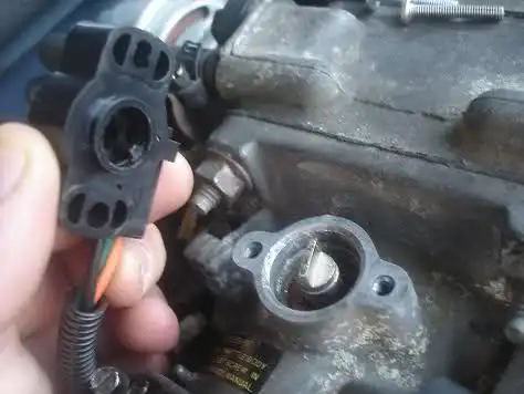

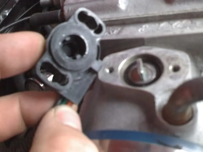

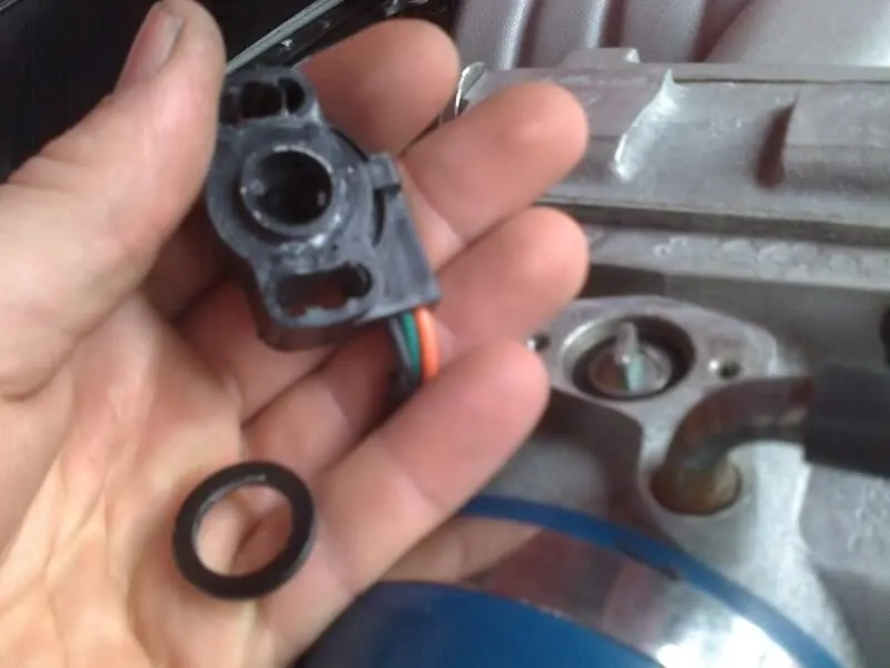

Ya that doesn't sound good. I guess if it's not going in there straight it could be wearing it out. I took some pictures of mine. I'm not sure if it's the same as yours because mine is a 70mm BBK. I hope it helps. I looked all over the garage but I can't find my factory one.

Which piece are you missing? The black washer thing in my hand or the piece that is still inside the throttle body? The piece that is in the throttle body I believe is a bearing of some sort. The one in my hand is just a plastic washer that you could probably pick up at a hardware store for 10 cents

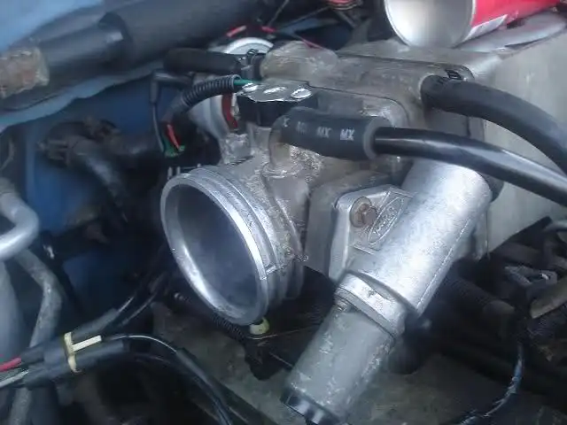

Heres a pic of the way it looks
Mustang5L5
Mod Dude
Feb 18, 2001
43,298
18,003
224
Massachusetts
Jun 23, 2010
#11
  • Jun 23, 2010
  • #11
Your throttle body looks odd. Doesn't look like a stock mustang throttle body which might be why it doesn't fit right.

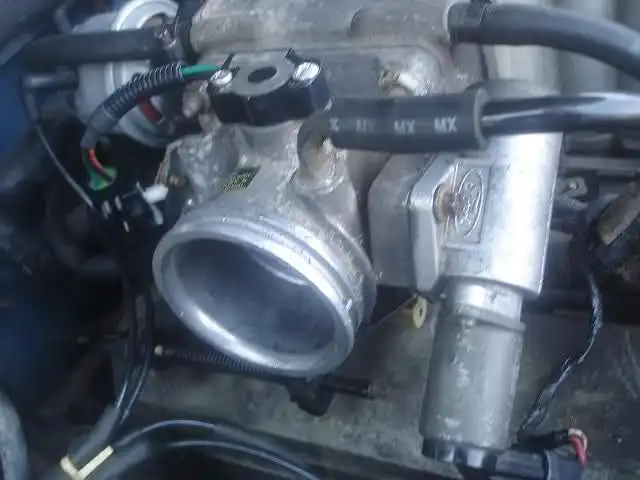

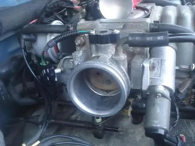

I think its a stocker. It was on the car when I bought it 6 years ago. heres pics
Bills89GT
Jun 16, 2010
127
Canton CT
Jun 24, 2010
#17
  • Jun 24, 2010
  • #17
I did some searching around on google images and it looks like you are correct about it being a stock one. In that case if it were me I'd just look around for a 65 or 70mm one. I got my 70mm BBK with EGR spacer used for $50 on craigslist. If you don't want to spend the money I guess you could get creative with a washer or a hose like you said. Maybe someone else on here has some better ideas for you too
