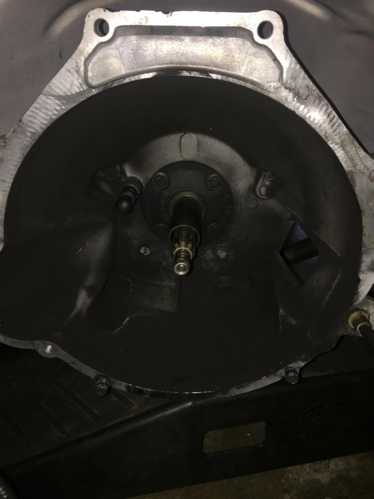

hey guys, does anyone happen to know if installation of the steel bearng retainer on my TR3550's input shaft is similar to the T5? Is there a race and bearing to transfer over from the old to the new? thanks

My motor is out of the car so acces to it is not a problem. Looks to be just 4 bolts? Is there more to it?
