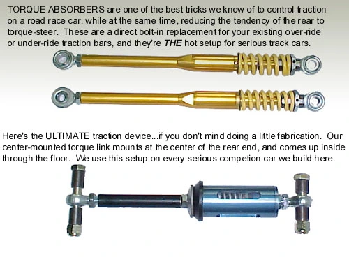

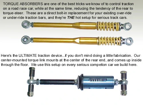

Cobra Automotive also has several different designs available including the standard rigid type (not pictured).
