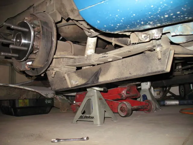

I got some old school SSM bars, some people like them, some think they're junk. I can't argue with 1.47 60 ft times on a street driven II. With the quick time tires, and a somewhat clean road, I can get it to hook like it does at the track. The suspension just flat out works, and I don't have much done to it. Gotta love the look on peoples faces when you pull the front wheels off the ground right in front of their eyes. I'll take some pictures of them in a bit when I get over to the shop and post them later tonight.

I can attest to the mechanics of the SSM bars. I run mainly street tires and the car seems to bite decently. These bars actually cause the ass-end to raise-up when you lay into the throttle, effectively 'planting the tires' . Never had regular slapper bars do that.

A picture as promised, also can see the new axles

Thanks for the pic parthos. I have ordered the stumpy's traction bars so i hope they hook up like the SSM ones. Also going to finally put in a high torgue starter and not have to worry about starting her up when its hot.I will have to learn how to post some pics here, i think you guys will like the way it looks.

BTW thumbs up on the pic showing the new axles also. you have answered my long time question on the 5 lug conversion. now i can go and get those axles and put my all time favorite style of rims on,crager ss wheel
