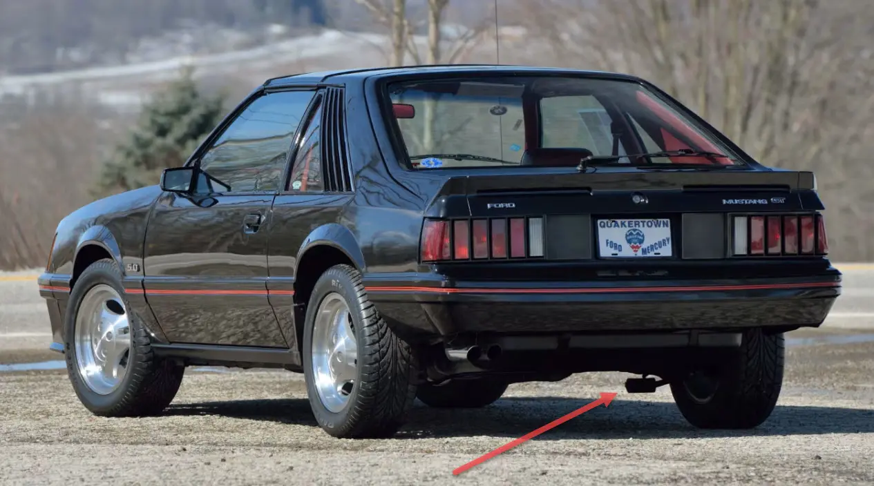

Does anyone know where to get a pair of these.
Haven't seen any used on foxbodys, but to stop my wheel hop the first thing I did was full length subframe connectors then a good set of rear upper and lower control arms. After those mods I have not experienced any wheel hop.even when I removed the quad shocks( aka bandaids)
Maybe something like this?
Reactions: frwgt350net
Perfect, thank you - I'm wondering if they'll adapt to a 1986 GT with the 8.8 - any thoughts
