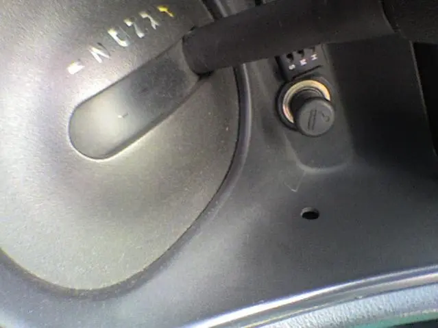

See attachment...
This is the hole I don't know why it is there... I do have ABS but I do not have TC... it looks like a factory hole, not done by the previous owner...

The button in the 2001-2004 is in the lower radio face plate. The 99-00's had T/C and I think it was the old style switch that 5L5 posted the link to ebay to.
nah i dont think so man, i have a 99 and i have that switch :scratch:
just to clarify, i have a 99 and i have ABS and T/C, AND its the same switch as said switch above, in the position that the defrost button would be in the newer mustangs (01-04).
Yeah, I'm not 100%....I should know this, because I had a 00GT back in 2004. I remember turning T/C off, but don't remember locaton of the switch.:rlaugh:
Here you go.
If you have a 99-00 and have traction control. There is where the button is on Auto and Manual cars. You can have ABS and not have T/C though.
if you have a 01-04 and have T/C, the button is here under the radio. For 01-02, the button has a spinning wheel icon on it like the green wheel in the dash. For 03-04, it says Trac Off.
It's a package deal so if you don't have the button, you don't have ABS either for those years. For 2004 it's an $800 option, so a lot of '04 GT's just have a blank delete switch.
