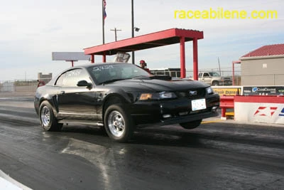

Learn to launch it, u probly dump your clutch like a rookie. Slip it from 3500 and u should be ok, i can dump mine i dont think i got 300 hp though mines slow and gay

Built rear end for those nice slicks i have ya i ride 3 wheels

The key to launching is slipping it. Any mustang can smoke the tires if you dump it.

I actually launch at like 1200 rpms??? Anything else and i would be just doing burnouts If i launch at 1200 i get one slip of the rear wheels then power to 3000, then i lose traction again. Whats this about slipping the clutch at 4800, that sounds like you would be roasting the clutch?? I understand that doing that you dont get the driveline shock like i do at 1200 dead drop???

dont dead drop it. launch by bringing your rpms to what you want to launch at, start letting the clutch out, whe you feel it start to grab gas it, and keep releasing the clutch as you drive out of it. This is done much faster then it sounds the way im typing it. your almost dumping the clutch just going a tad slower. now your gonna burn out your clutch. sorry.
