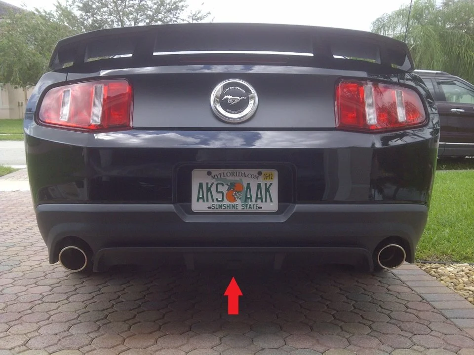

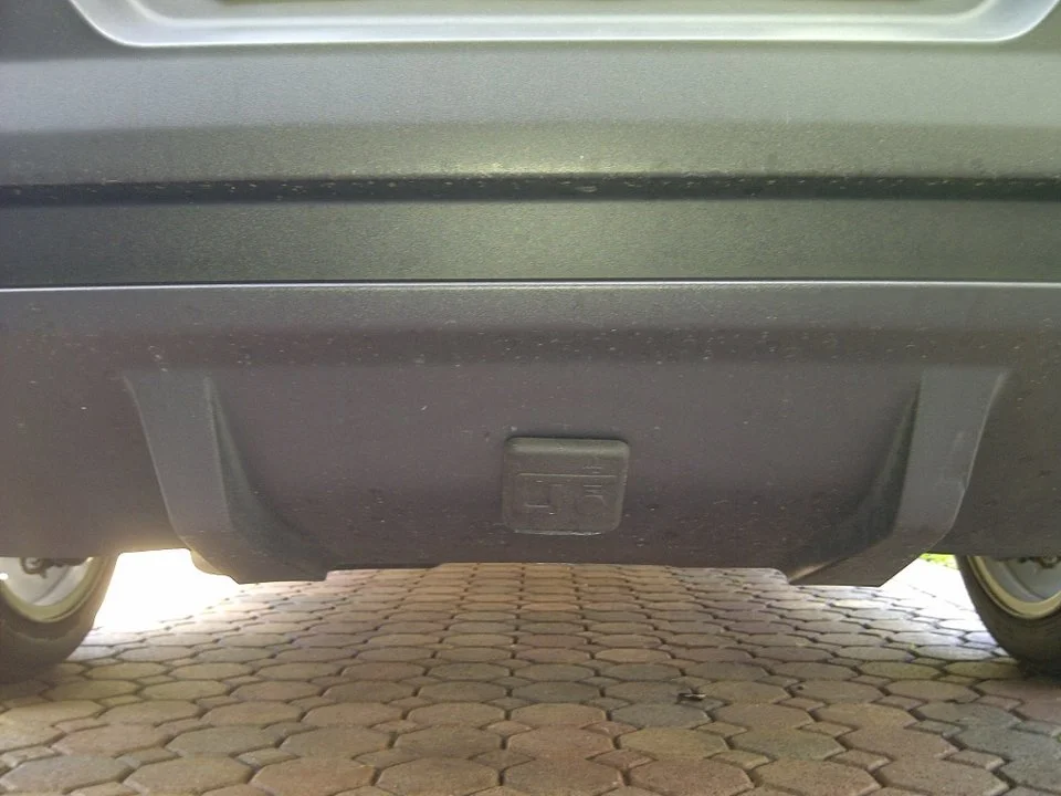

I've got a Draw Tite Part#24747 I purchased from hitchesforless on my 2010 Mustang GT. I originally purchased it for a 2008 GT California Special and had it on a 2009 GT/CS as well. I tow a Kendon Motorcycle trailer and one or two motorcycles ( under 2,000 lbs ) no problem. Yes they do fit the Shelby GT's and GT/CS dispite what you have read, just pinches the rear bumper a little bit.
The instructions tell you to drop the mufflers but you don't have to, just take one of the short carriage bolts to your local hardware store and get four 5 inch ones of the same diameter then you can just run the bolt through the frame instead of having to muck around with dropping mufflers and fishing the bolts into the frame. With a jack to hold the frame in place it shouldn't take you more than 20 minutes to install.
On my 08/09 GT/CS the standard 4 wire trailer light plug worked just fine, spliced right into the wires (read/white) in the trunk and ran the pig tail down out through the bottom left electrical rubber boot. On the 2010 Mustang GT (yellow/red wires ) I could not get the trailer lights to work with the sequential tail lights until I replaced the trailer's light bulbs with 1157 type LED bulbs.

I am in the process of installing this same hitch and though this was a great idea. I couldn't figure out why the manufacturer wouldn't design the kit this way. I purchased the 5 inch bolts and this method definitely makes the install quicker and easier. Until, that is, you attempt to tighten the bolts to the specified torque. At this point you will find that torquing the bolts to the specified 50 lb.-ft. will collapse the hollow unibody frame 'rails' before reaching that torque. The reason the manufacturer designed the kit with the fish lines is to ensure the bolts are attached to a solid piece of metal, not a hollow unibody box.

Well I have to say I installed the same hitch on several mustangs and never experienced that problem. But then again I don't ever recall using a torque wrench during the install process and only tighten the bolts enough so they don't come off, i don't know what torque that was but it wasn't much more than I could get on it with the socket wrench laying down underneath the car, and for sure nothing got crushed.
By my account using this method the NUT is NOT what is holding the hitch in place it's the BOLT, just tighten the NUT enough to keep the NUT from coming loose.
Well just my two cents and I never had any problem towing a couple of motorcycles several thousand miles (from South Florida to North Carolina and back) over several years. I don't think I would do it any different on a car I was going to keep for one year or several years.
Try lock tight next time, and better yet, check your nuts each time both before and after you use them. If you uncomfortable with that by all means follow the instruction in the manual.
