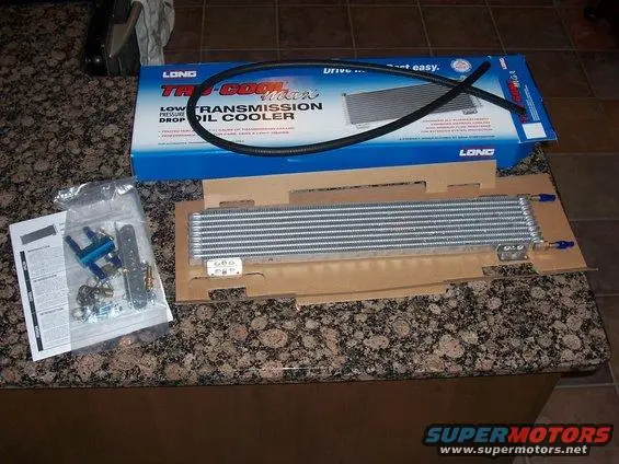

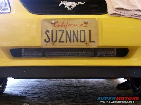

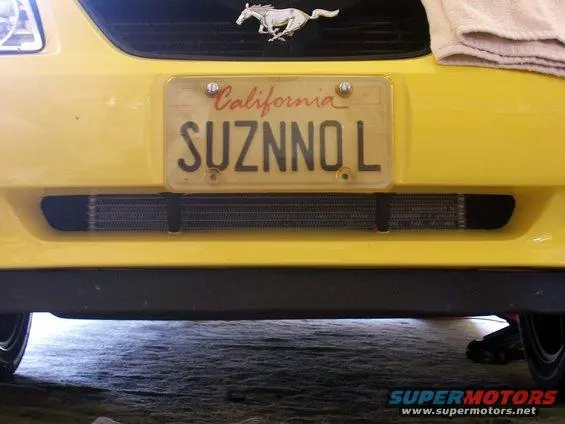

I installed this one last summer when I also installed my Fluidyne Rad. A little pricier than the B&M but I was looking for something with these dimensions that could be mounted in the lower cowl opening.

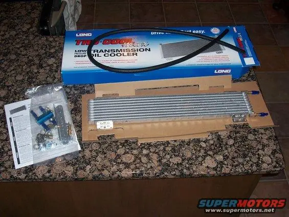

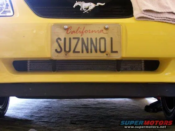

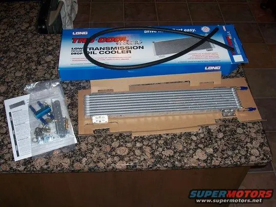

That one looks nice. Where did you buy that one from? Which one do I order? The 16GVW or the 24gvw

I got the 24GVW, I don't think they make a 16 or at least they didn't when I got mine just 24, 30, and 40. Below is a ink to the seller I got it from on eBay. Just make sure before you purchase that your kit comes with a thermostat (that's the blue thing in the parts baggie above) as they offer the kit with or without it. When I first installed it I didn't install the thermostat since it was July and the trans never went over 160. And even though you want to keep the fluid cool you don't want it cold. I installed the themostat in Sept. in about 15 minutes and now the fluid warms and stays right at 180.
