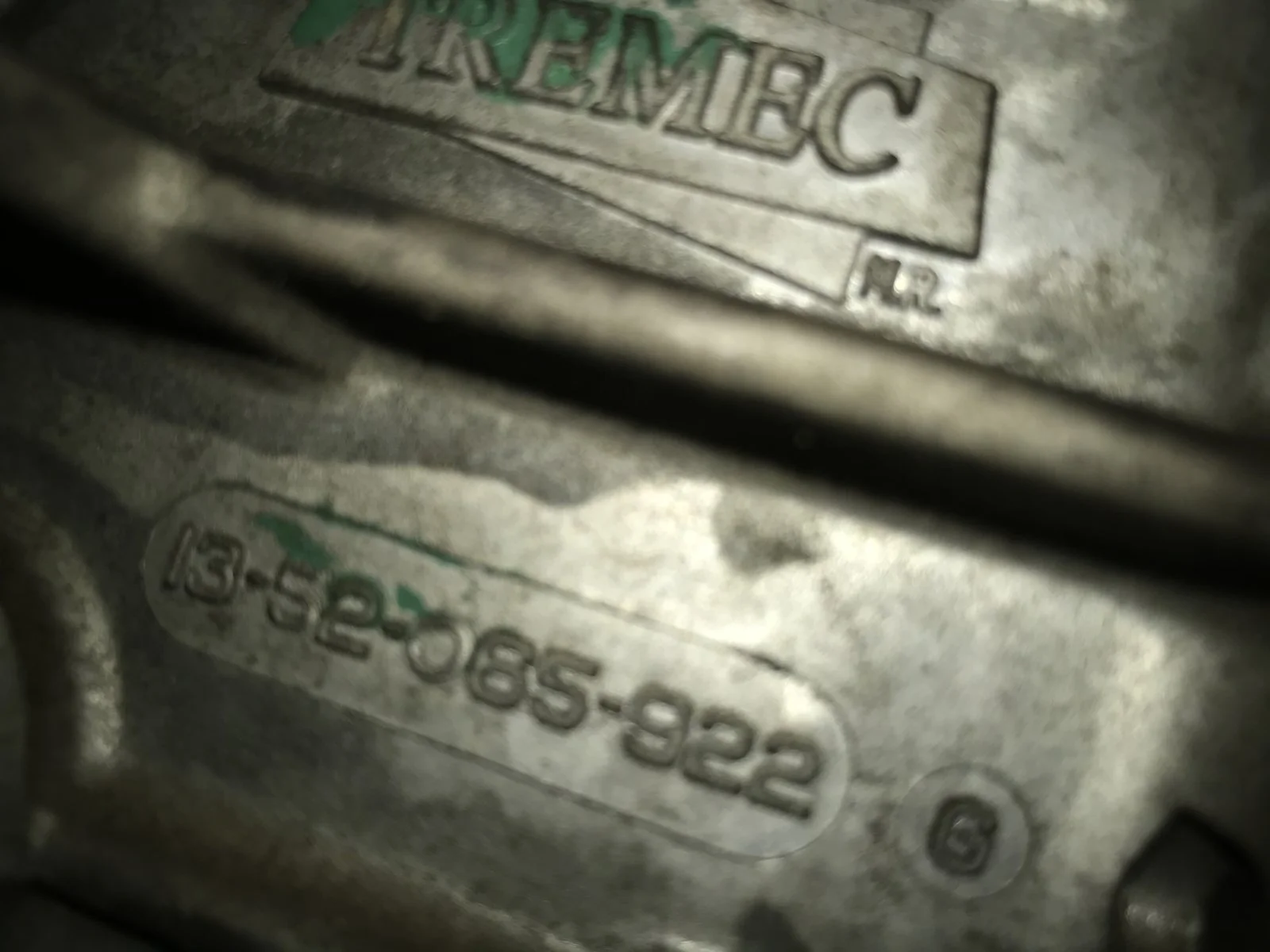

So I did buy a new tranny many years ago for my other 5.0 that I wrecked then swapped into my current car when I bought it. It’s an older Tremec 3550 from what I can remember but maybe I am wrong.
That is the main case number which only tells you that it was made in 1996 or later. You need to look at the ID tag which is typically on the left side of the transmission near the tail housing and has one or two letters followed by six digits. That'll tell you everything about it but to confirm it's a 3550/tko verses a T5 just count the number of bolts used to bolt down the shifter. Four bolts would be a T5, six bolts is a 3550/tko. To tell if it's a tko or 3550 you would need to count the splines on the input shaft or look up that ID tag.
That is the main case number which only tells you that it was made in 1996 or later. You need to look at the ID tag which is typically on the left side of the transmission near the tail housing and has one or two letters followed by six digits. That'll tell you everything about it but to confirm it's a 3550/tko verses a T5 just count the number of bolts used to bolt down the shifter. Four bolts would be a T5, six bolts is a 3550/tko. To tell if it's a tko or 3550 you would need to count the splines on the input shaft or look up that ID tag.[/QUOTE
Ok so I’m guessing it’s not a 3550, guess it was a Tremec T5 bc this is the number on the tag by the tail 1352251 2405.
