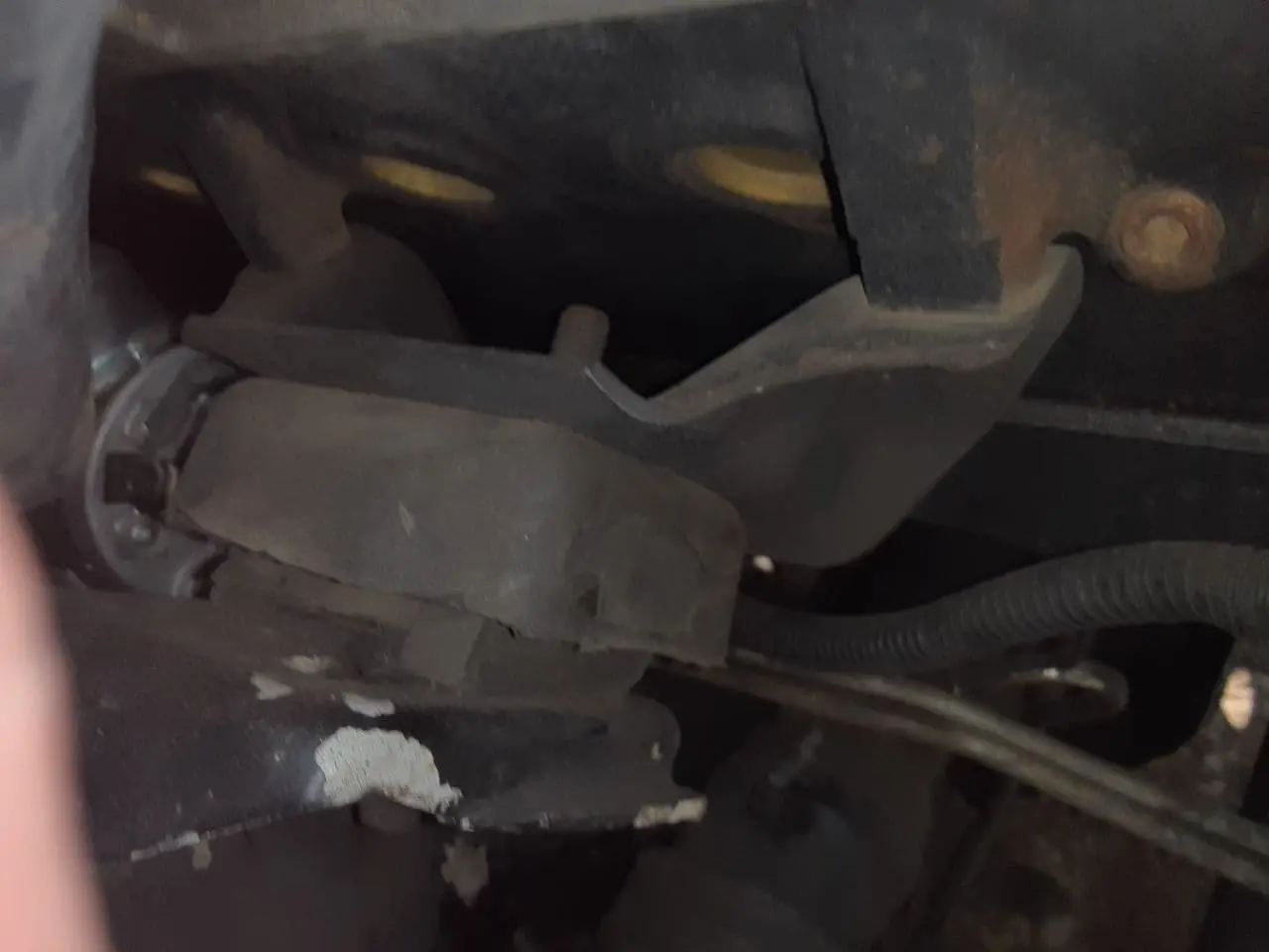

mounts…how is the engine mounted? how is the transmission mounted?
solid engine mounts, and a rigid trans mount wont provide enough flex in the drivetrain, and the trans took the brunt of the torque. ( you’re supposed to keep the rubber mount when mounting the engine solid). Bad or loose engine mounts allowed stuff to twist, and again, the trans took the brunt of the torque.
it’s not the trans…it’s how you have this sht mounted.

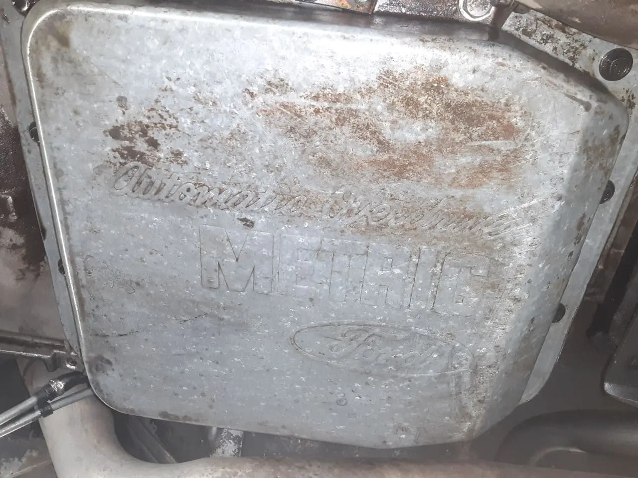

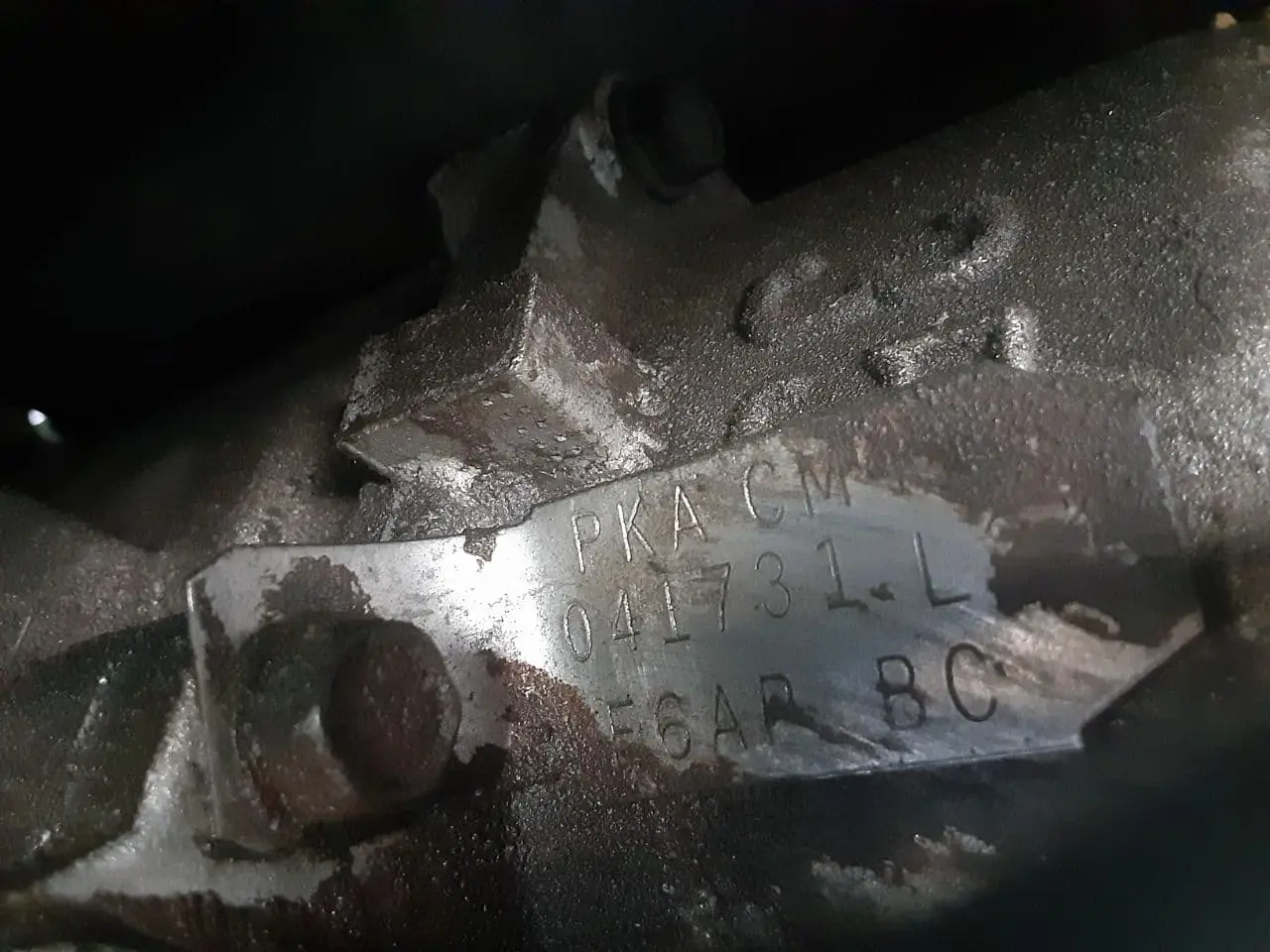

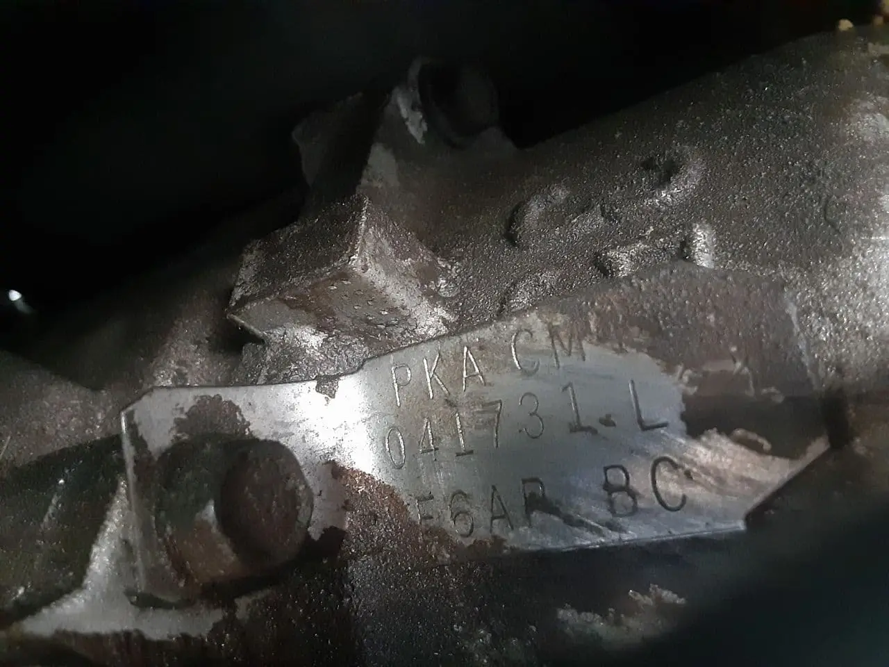

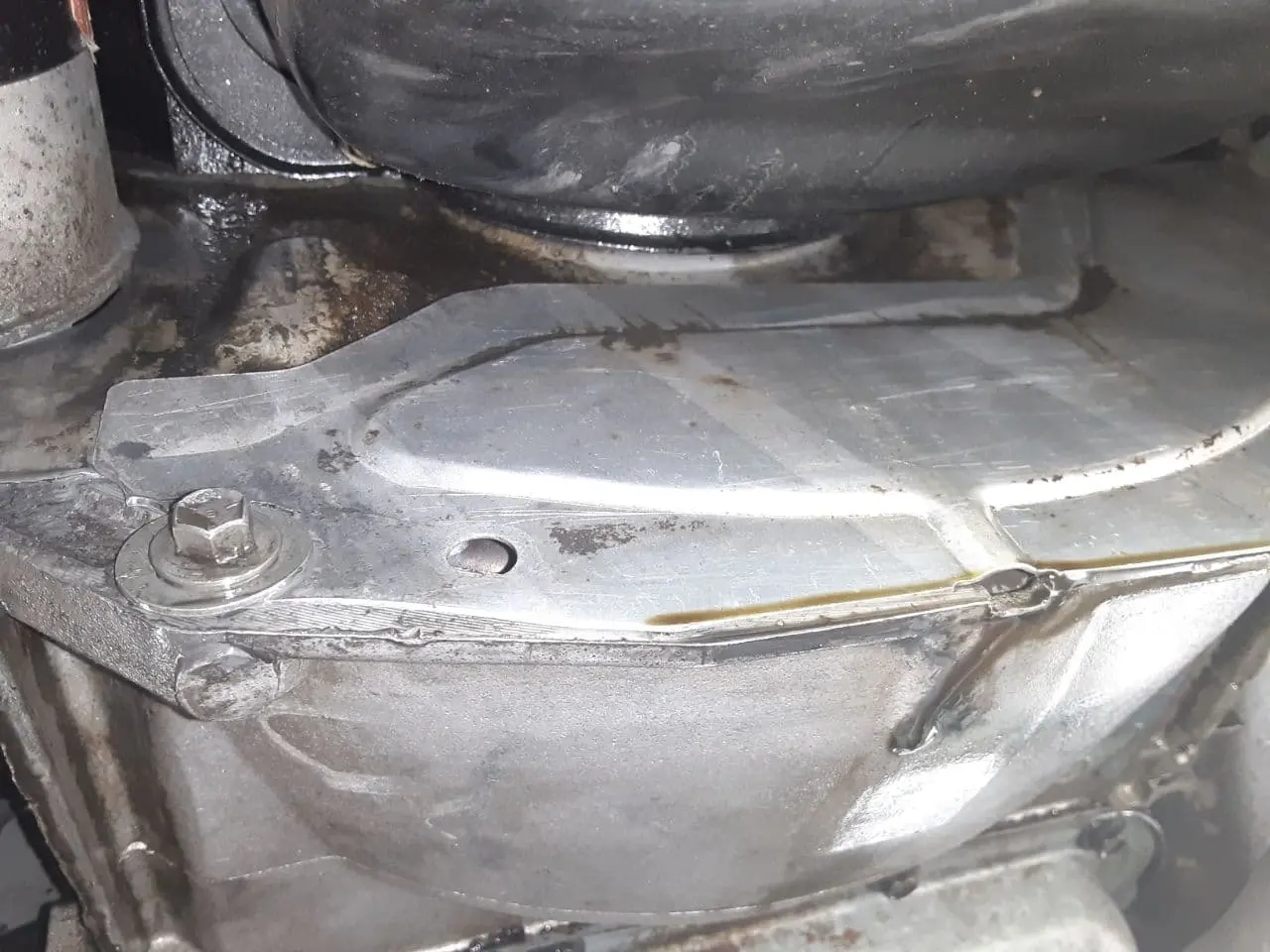

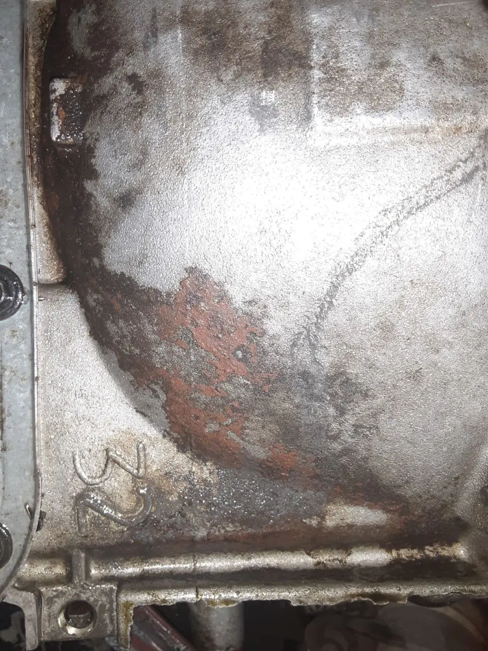

Here are some pics of the tranny. Any help identifying what trans I need for direct replacement is appreciated. I'll figure the mount thing out after I figure out trans ID.

Here is a pic of the top of the transmission bell housing where it attaches to engine. All the mounting bolts top and bottom were tight. And a pic of engine mounts showing some sort of rubber/poly mounts.

here’s an idea…find the freakin i’d tag on the side of the trans….that’ll end all of this guessing.
