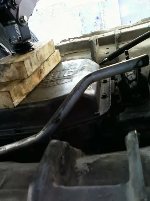

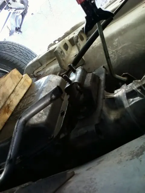

This one shows where the transmission pan will be contacting the crossmember...

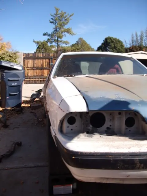

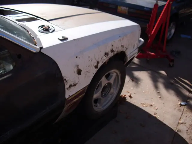

And just a few extra's... i wanted to see the capri fender's... i think they'll look good. but if not i have an extra set of mustang fenders for it.
Some wet leaves on the fenders
