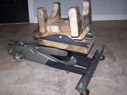

Curious about jrichker write up on building tranny jack. Swapping out my clutch and wanted to built something around a floor jack to support the t5.

Send me your email address: the jack pictures are almost near 9 MB in a zip file format.
Sample picture...

One thing I forgot to tell you. You need some SUV size jackstands to do the job using the transmission jack. It takes a minimum of 24" of clearance to get the transmission out from under the car while it is on the transmission jack. I usually end up doing the jacking in stages. The last stage is with a 4x4 on the jack pad to get it up the needed height.
