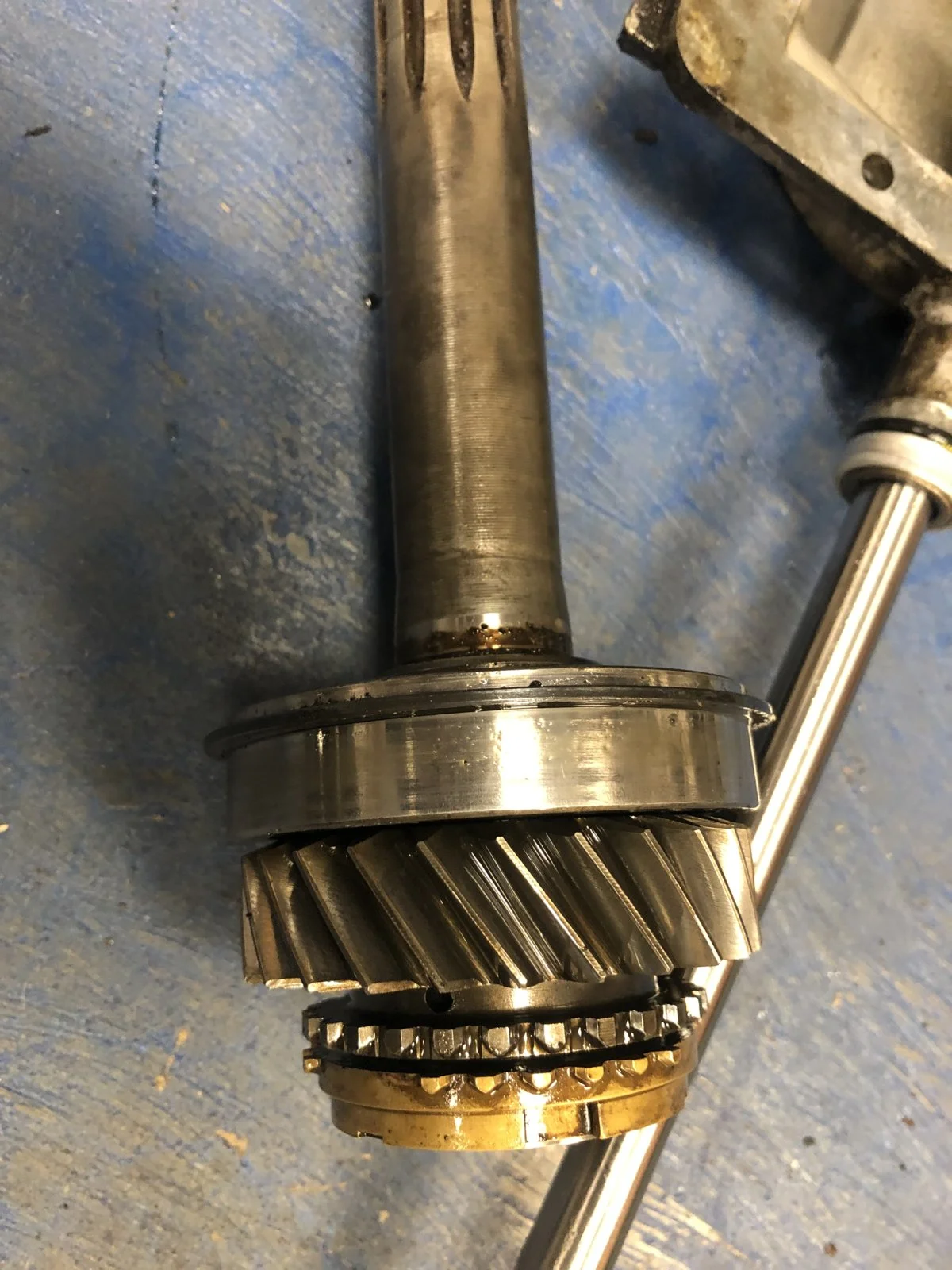

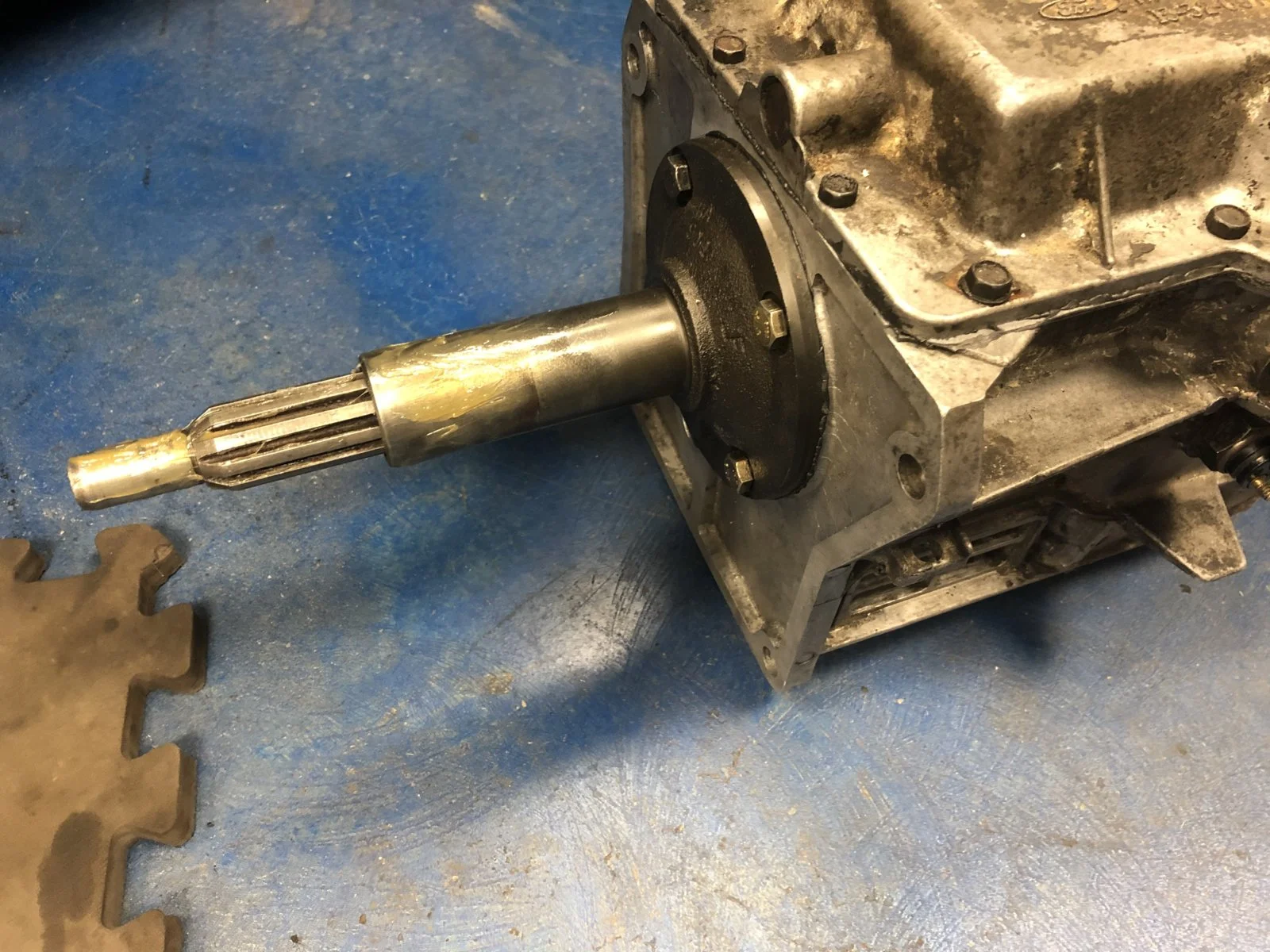

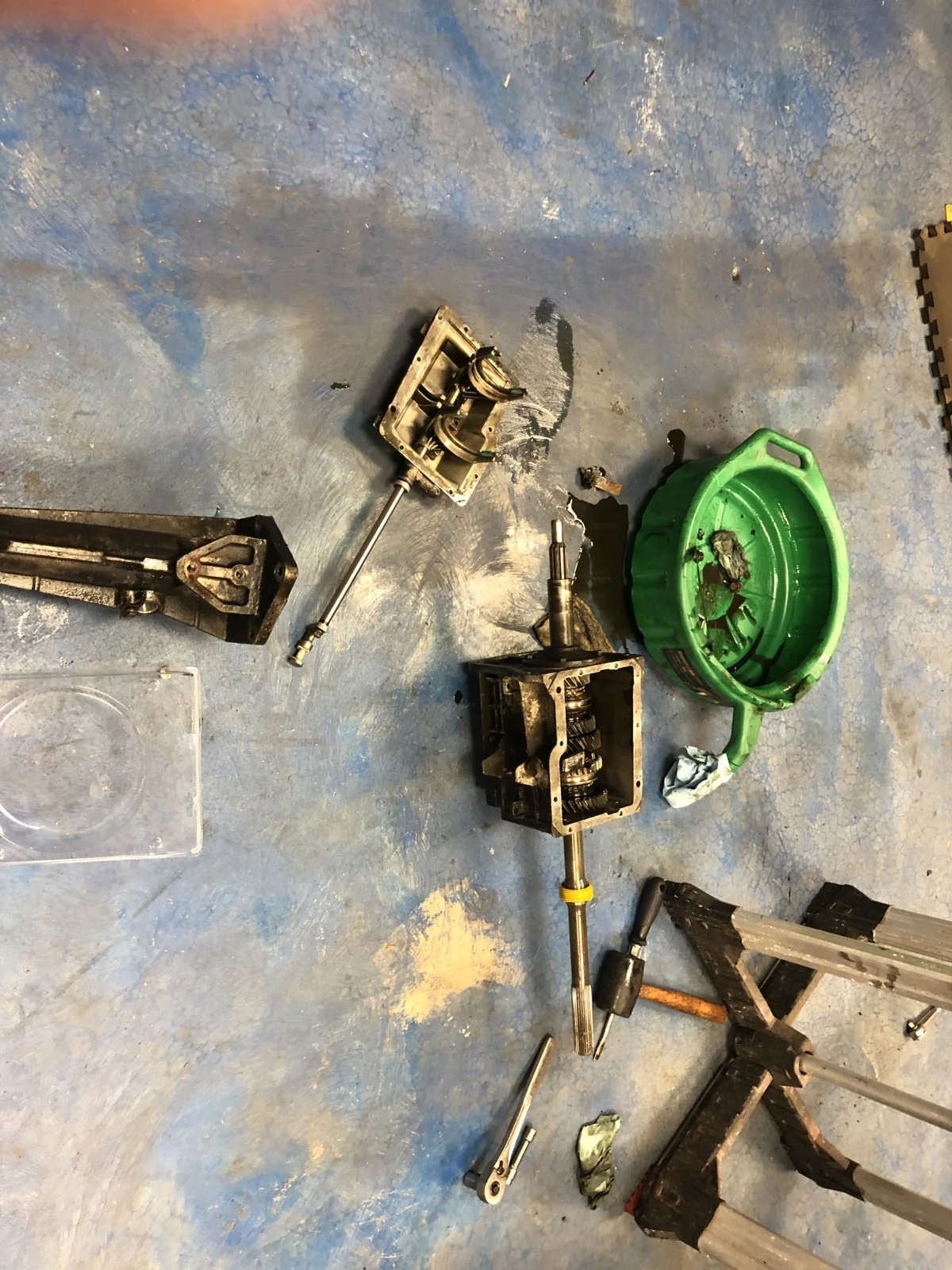

well well well , so transmissions out . the two transmissions i have 1 from a 4 cylinder and 1 from 1975 are different and won't work. input shaft wrong lenthg and size and tail shaft shorter on v8 trans, front input shaft for v8 has larger bearing and case for bearing is bored bigger on v8 so cases are not interchangable either. Hmmm someone did say to check this lol .My research didn't turn up dimensional differences between trans, just ratios .I am going to take a part v8 trans and see how bad it is , and either put new bearings in or might have to go for t5 swap. Was really hoping for trans swap. Didn't want to get this deep and expensive. anybody need 6 or 4 cylinder trans in nice shape.

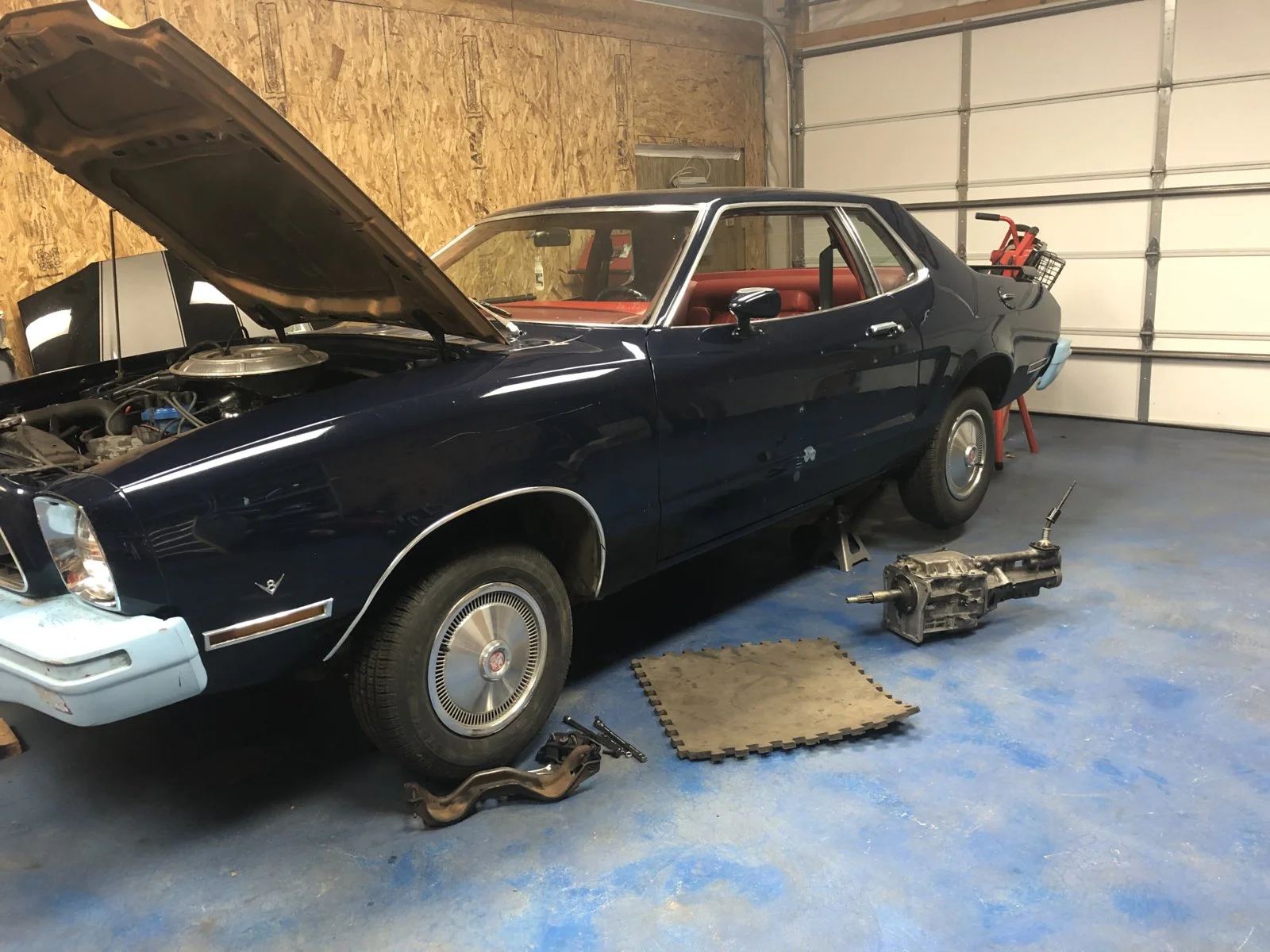

Your right about nothing easy. Lol. Its fun to drive and lots of looks when it was out. But trans was really grinding had to do it. Maybe i will post side by side pics for info “ of what not works lol. “

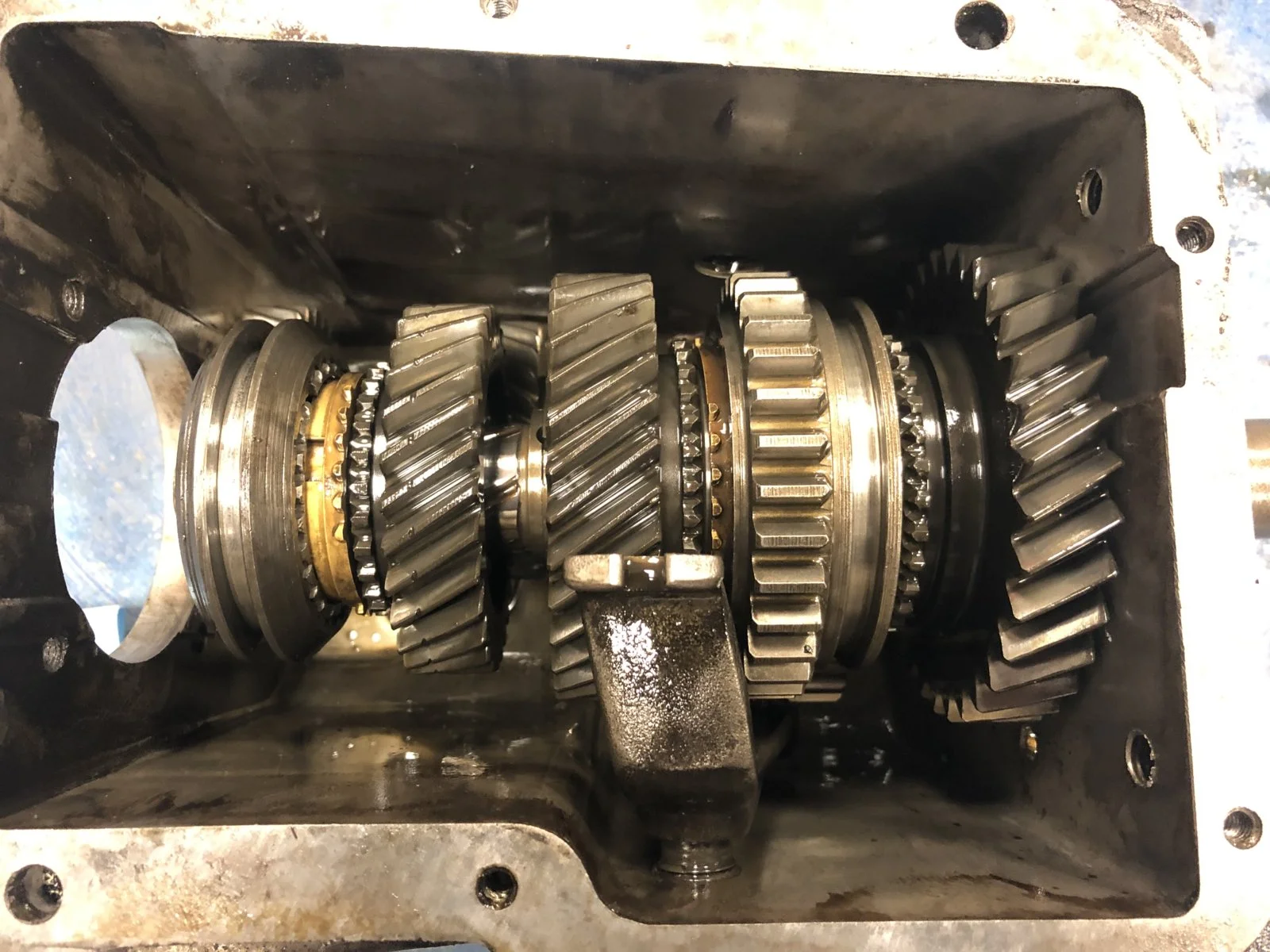

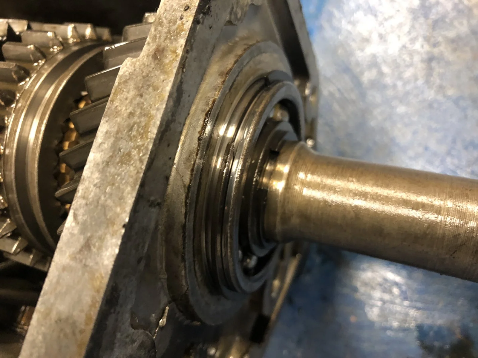

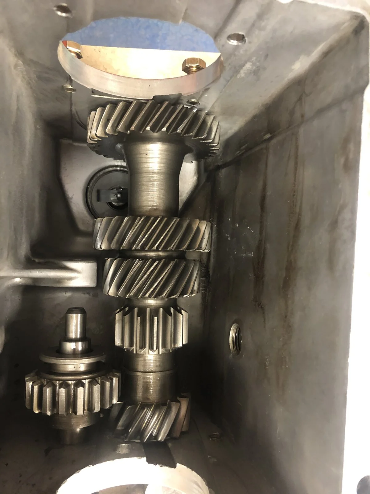

Decided to rebuild Rad W v8 trans , had bad rear main shaft bearing. Gears look great , ordered rebuild kit with syncros and tail bushing, and all seals. Was wondering if anyone knew if gear clusters are same shaft size as 6 cylinder trans . Might like to swap gears for better off the line .350 1st gear end ratio is still 1-1 on any trans, so bigger v8 input might fit.

Cool! Somebody said that your tranny is the precessor of the T5... now i see the pictures, the similarity is really very high.
Let us know if the gear swap works or not.

so did some research and checking on swaping input shaft with 6 cylinder cluster and installing in v8 housing. first gear in v8 housing on input shaft is 25/30 teeth , 6 cylinder is 22 /34 teeth so mixing the 25 with 6 cylinder cluster of 34 is going to cause a gear mesh problem. i can now take apart a Rad trans pretty easily lol and i got a better condition speedo tailshaft gear. Just going to rebuild the Rad w to stock, bought parts from cobra trans $112.00 delivered for everything ,gaskets ,seals ,bearings,fork pads and shifter saddle . nice metal made in japan bearings factory had plastic insert in ball bearings.

Trans done went pretty good , put back in car , drives very good lots of torque . Glad i couldn’t change ratios , have 185/70/13 tires on car, revs 2750 at 60 miles an hour . I pushed to 90 mph . Man it was loud. Lol. Lots of fun to drive . Has great pull when romping on it. Think 15” tires will help ?
