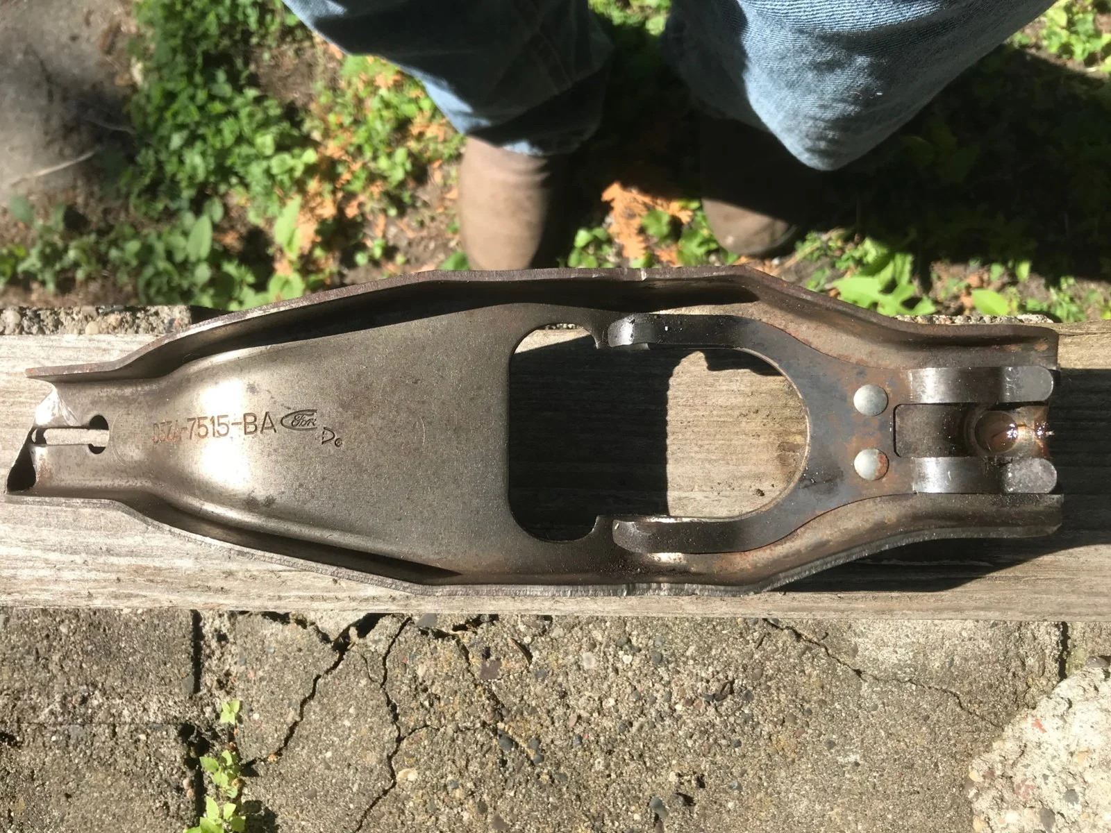

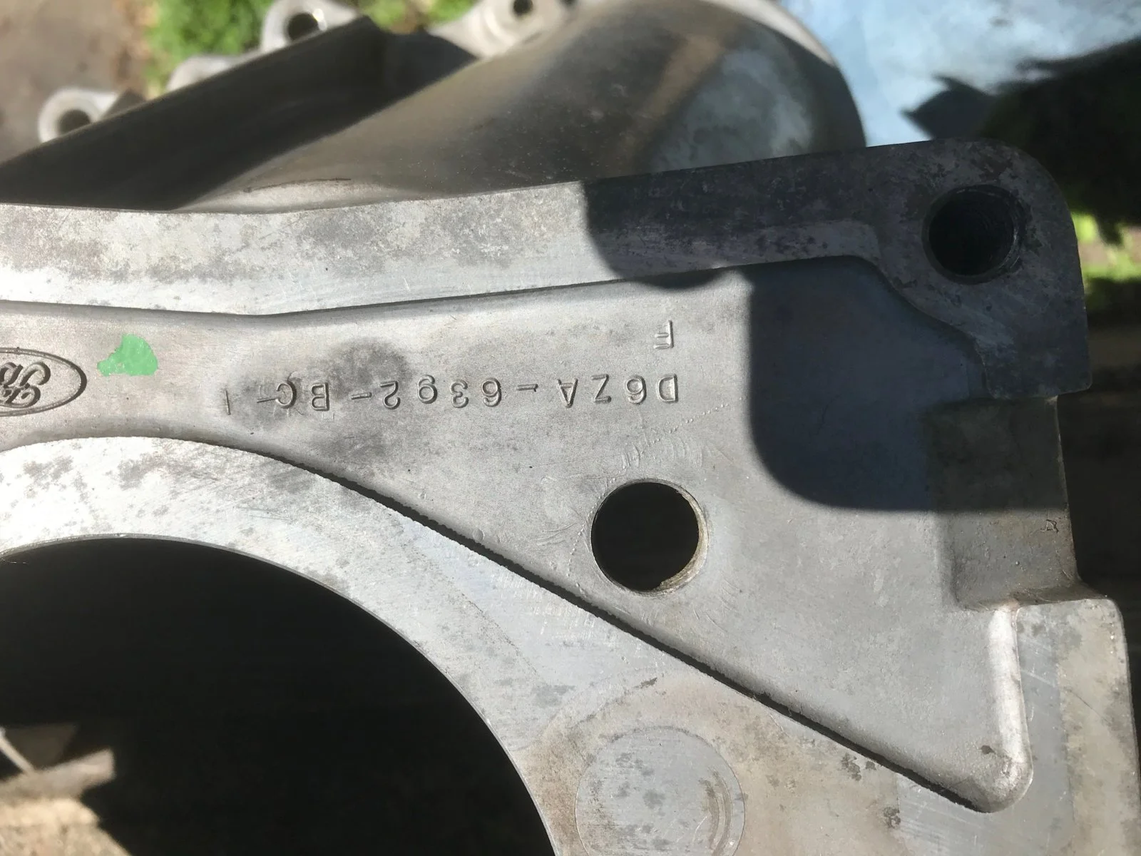

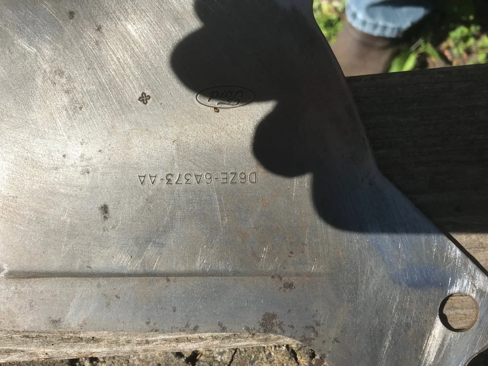

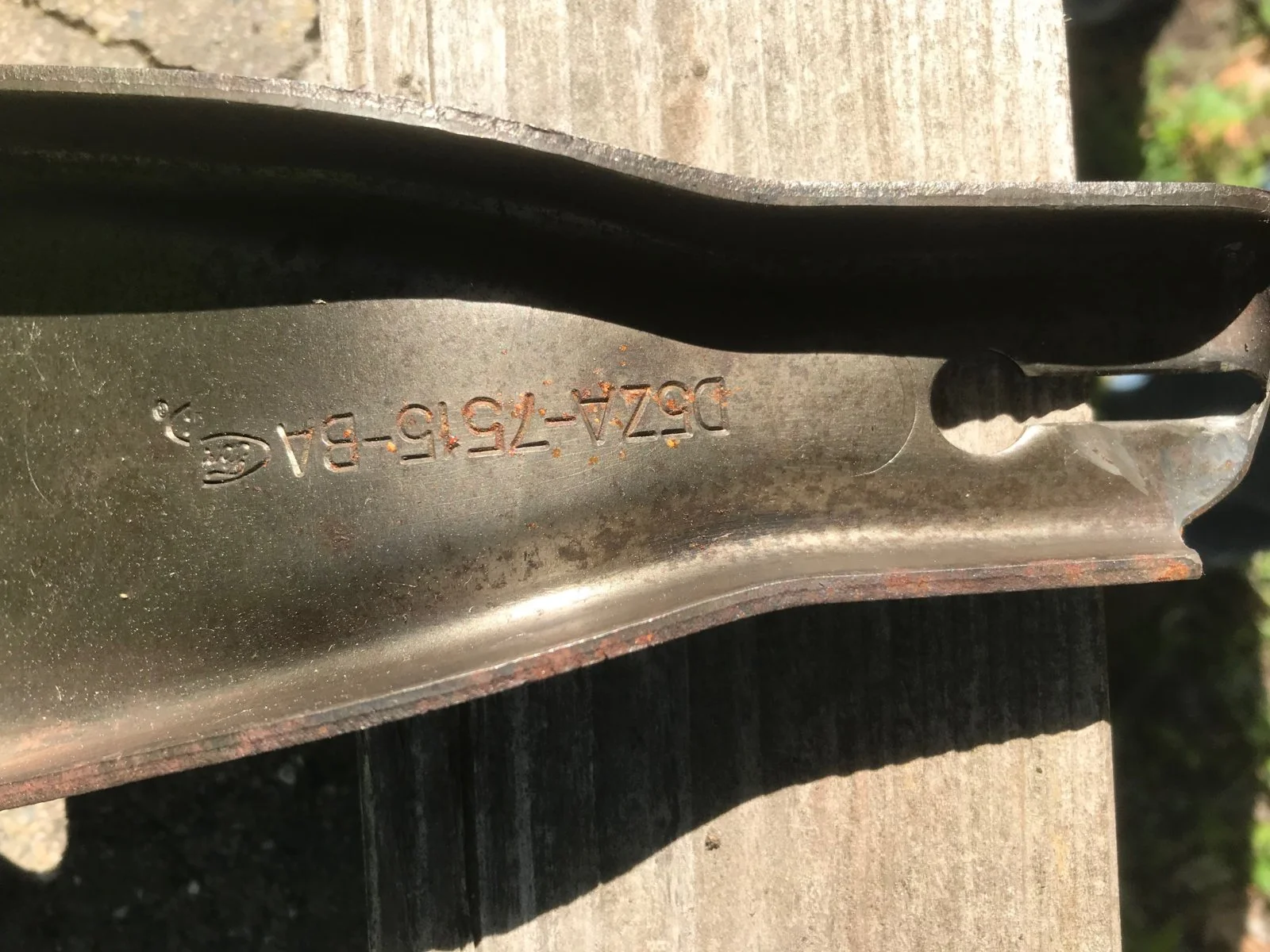

Right on Enzio!, its a start, Stock bell housing? Could you post pic of the fork and the part number on it?
And I want to see the carnage of the old one. :nice:
Thank you. Day 2 gets posted to YT today and Day 3 tomorrow. Waiting to get the flywheel back from the machinist.
Here is the clutch fork. Modified to miss the headers. I'll fill that in and reform the slot/groove for the clutch cable. Pics also of the bell and flex plate part numbers. Everything is good except the lever which I'll make good.

It kind of sucks that its not a bolt in after having to machine the flywheel for the new plate and cover.
So the pressure plate teeth are closer to the engine than the stock one?
Will there be enough travel in the bell clutch fork hole? I've seen a couple mutt2 bell housings on line that are cut for more fork travel.
