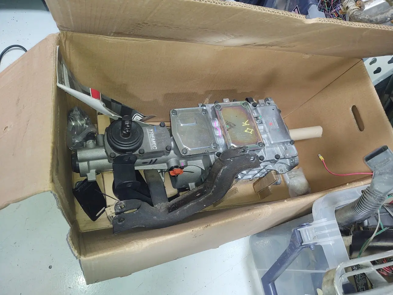

Okay, I need your help here, guys. I'm getting some work done on my '65. Texas has a friggin' inspection, and I'm getting a bunch of little stuff done.
I'm at a reputable "Restoration/Repair" place, and they were doing some impressive things when I was in there. I'm comfortable with their quality.
We talked about doing some other things, and one of them was to replace my toploader (needs a rebuild BAD) with a Tremec TKO. Eh, I like the idea, so I asked for a quote. The head guy came back with $6,500 for parts and another $1,000 for labor. In my heart, I'm thinking close to $10k to put a new transmission in my car is a bit much, BUT I DON'T KNOW . . . so I put it to the team here . . . what's a reasonable price to put a Tremec TKO in a '65 with them supplying all the parts?
Thanks Team!
A TKO runs $3000 new or so(or used to anyway). Depending on the clutch actuation parts you choose(cable, hydraulic, upgraded Z-bar) it could be another $1000 or so, maybe a few hundred more if using a custom adapter plate or bellhousing. As for labor...$1000 seems fair(for average shop pricing) depending on which kit they are using. Then you have to add in other parts like clutch, driveshaft, etc etc...all these things cost quite a bit from big name suppliers. $7500 is on the high side...but being brand new/no shopping around prices, its not all that surprising. That isn't to say you cant do it cheaper. If I were you, I would collect the parts as I could and just take everything to them for the install if you don't feel comfortable doing it yourself. For example, you could probably find a used TKO in the $2000 range(but if there is any part you want new its the trans itself), you could buy the clutch from a local clutch shop instead of a big name dealer like Centerforce(for example, at my local clutch shop I can buy a an entire clutch, with disc, pressure plate, TOB and pilot bearing for a little over $100 and be out the door under $200 by the time they surface my flywheel, etc). My local driveshaft shop charges me about $80 to shorten an existing driveshaft. I could put together a hydraulic clutch actuation setup for $300 or so, etc etc etc...in other words, if you spent your time you could probably accomplish this on your own for about $4500 with a new transmission, but not much less.

Thanks for the great response. I've found TKO's on sale online new for $2,600 . . . so I figure another $200 to $500 for shipping. I found a "TKO Kit" for a vintage Mustang, and it was about $4,000, and got excited. The gigantic "but" here is that's $4,000 for an installation kit, but there's no clutch kit, bellhousing, shifter, blah blah blah . . . so there's probably $1,500 worth of stuff not in the kit I'd need, anyway. The more I dig in, the more "ok" the $6,500 is. And I'm assuming they're going to use premium parts, so there's that. I'll get receipts for all that jazz.

Okay, long time before an update, but here goes . . .
The transmission works great . . . no problems. It's REALLY WEIRD having a 5th gear in my girl. I got on the interstate, cruised up to 3k RPMs and relaxed . . . and then I remembered I have another gear. Wow . . . dropped to 1,800 and just cruised.

BTW, the shifter works okay, but there's tons of play. Recommend a better aftermarket shifter??

What rear end gear ratio are you running out of curiosity? And whats the 5th gear ratio in the TKO?
