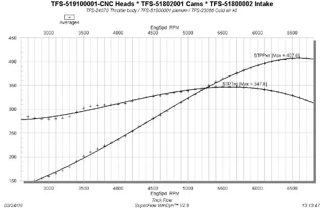

The number I saw were 241/177. For a 4.6l to be able to use this flow it will need to turn 7200-7400 RPM.
Let me add a 5.4l will only need to turn 6100-6300 RPM.
The initial dyno numbers from Trick Flow are on an engine dyno. We should get some independent number soon.

Simulated 1/4 mile from TFS-CNC Graph Shifting at 6800
60 Foot ET = 1.80
1/8 Mile ET = 7.75
1/8 Mile MPH = 90.92
1/4 Mile ET = 12.09
1/4 Mile MPH = 114.38
Simulated 1/4 mile from TFS-CNC Graph projecting curve to 7400 RPM and shifting there see below
60 Foot ET = 1.79
1/8 Mile ET = 7.63
1/8 Mile MPH = 92.38
1/4 Mile ET = 11.90
1/4 Mile MPH = 115.59

I'm very curious about the heads, but I don't want to have to spin my stock bottom end motor to 7000 to get the power out of the heads. Looks like the peak power/torque has been moved up by about 1250 rpm. Racing would be great with these heads. I'm guessing with the right cams that they would be good for the street? I hardly see 4000+ rpm when I drive on the street, so it looks like the car would actually feel weaker than stock in daily driving. Its awesome that TF has come out with these heads. They look like they will make great power N/A for the 2V. I think it just all comes down to how you drive your car and what you want out of it. I'm still leaning towards the PD blower route because of my time spend under 4000rpm on the street in driving. I've been watching the thread on Modulardepot and I will continue to follow the heads though! :nice:

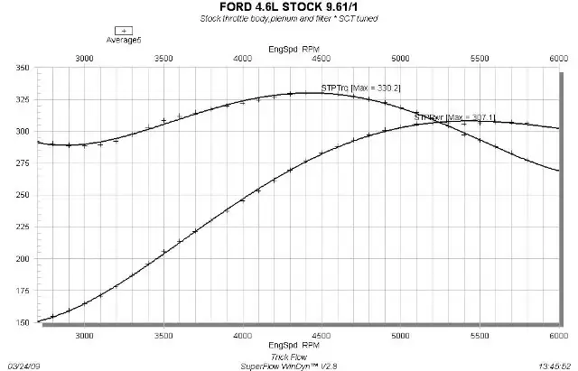

Anyone else have a problem with them claiming the stock 4.6 made 300 crank hp. IMO, that shows that all of their #'s are unreliable. Just my $0.02.
Yes, I agree. Unless that engine was ran without accessories, the tune and longtubes (which were probably on the engine if it was on an engine stand).
Who knows if it was stock, just says stock intake. At the least we know it has an aftermarket tune per the dyno description.
