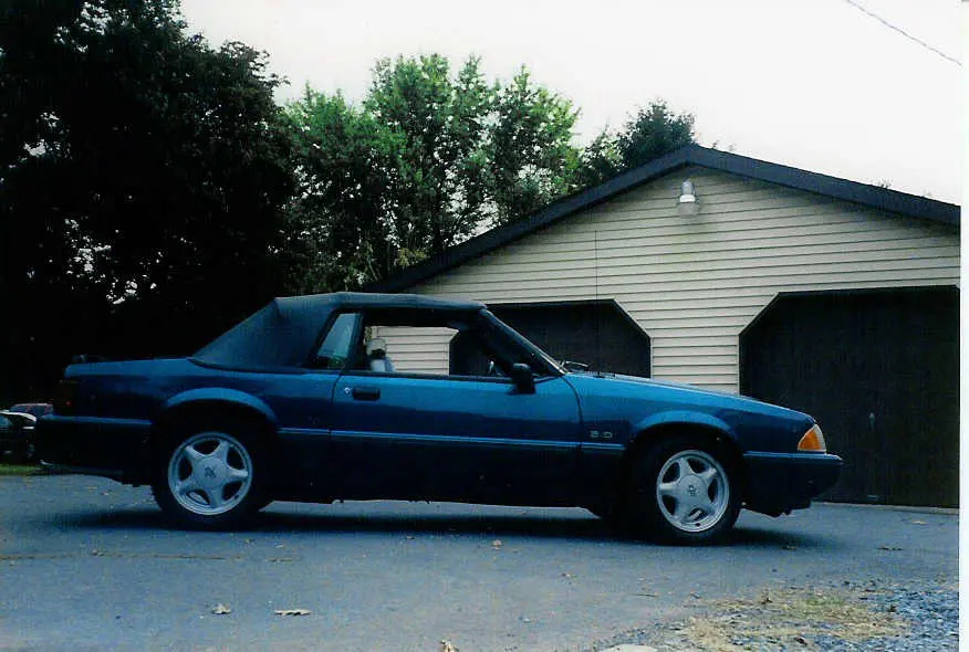

You might also look at the new Trick Flow package deal, sounds a lot like what you are intending to buy. I think it comes with Twisted Wedge heads, Street Heat intake manifold, and a stage 1 cam. Anyone have the link to this on Summit? I think I saw it once but can't find it again. It cost a little over $2000 but sounded like a great deal.
Hey Nice car man! Mine is very similar to the one in my avatar. Unfortunately I dont have any actual pics. I am actually thinking about gettin a black top, it has a white interior and might look odd, but I will just tint the windows so you cant see the interior with the top up! I will be putting my car together in the spring. She is away for winter now!

Yea 93vert, mines away for winter too, i have the white interior too. And thanks chris for your recommendation on the fuel injectors setup. I dont know i might as well get 30 lbs injectors right away with fuel regulator. Then i can crank up/down psi depending on what i want, then when i get my heads ill be ready. But thanks.
