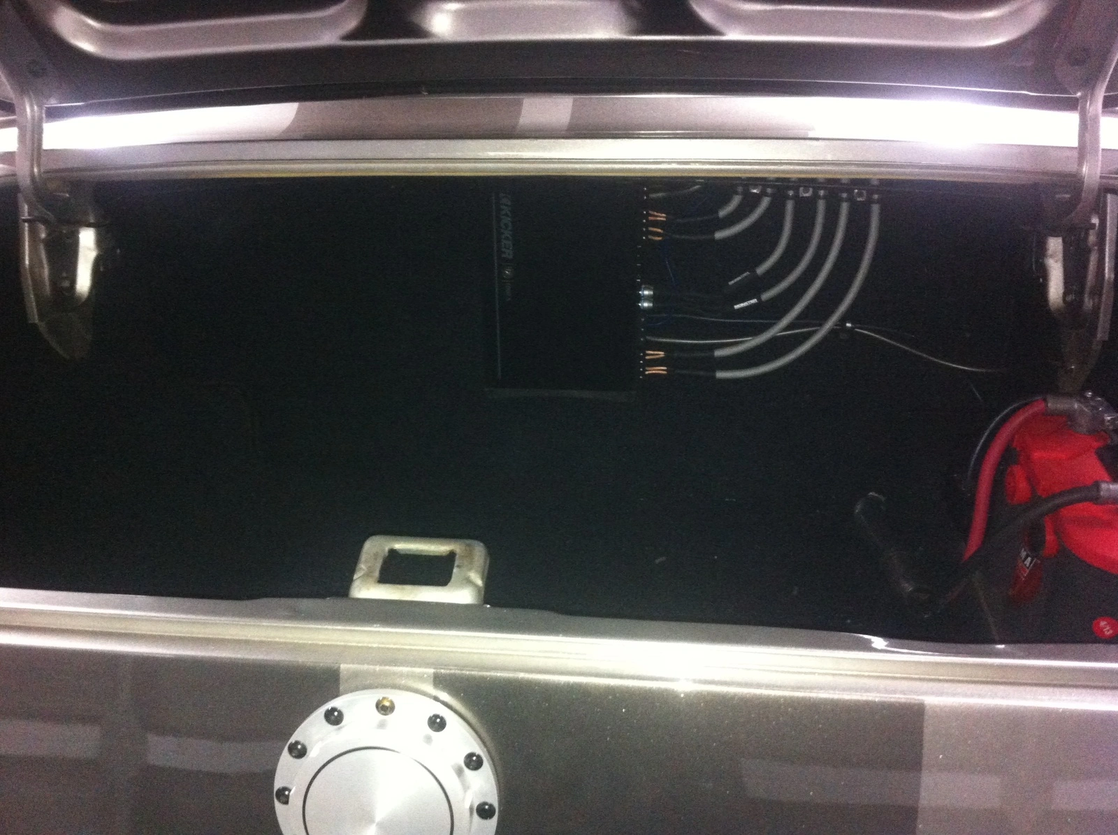

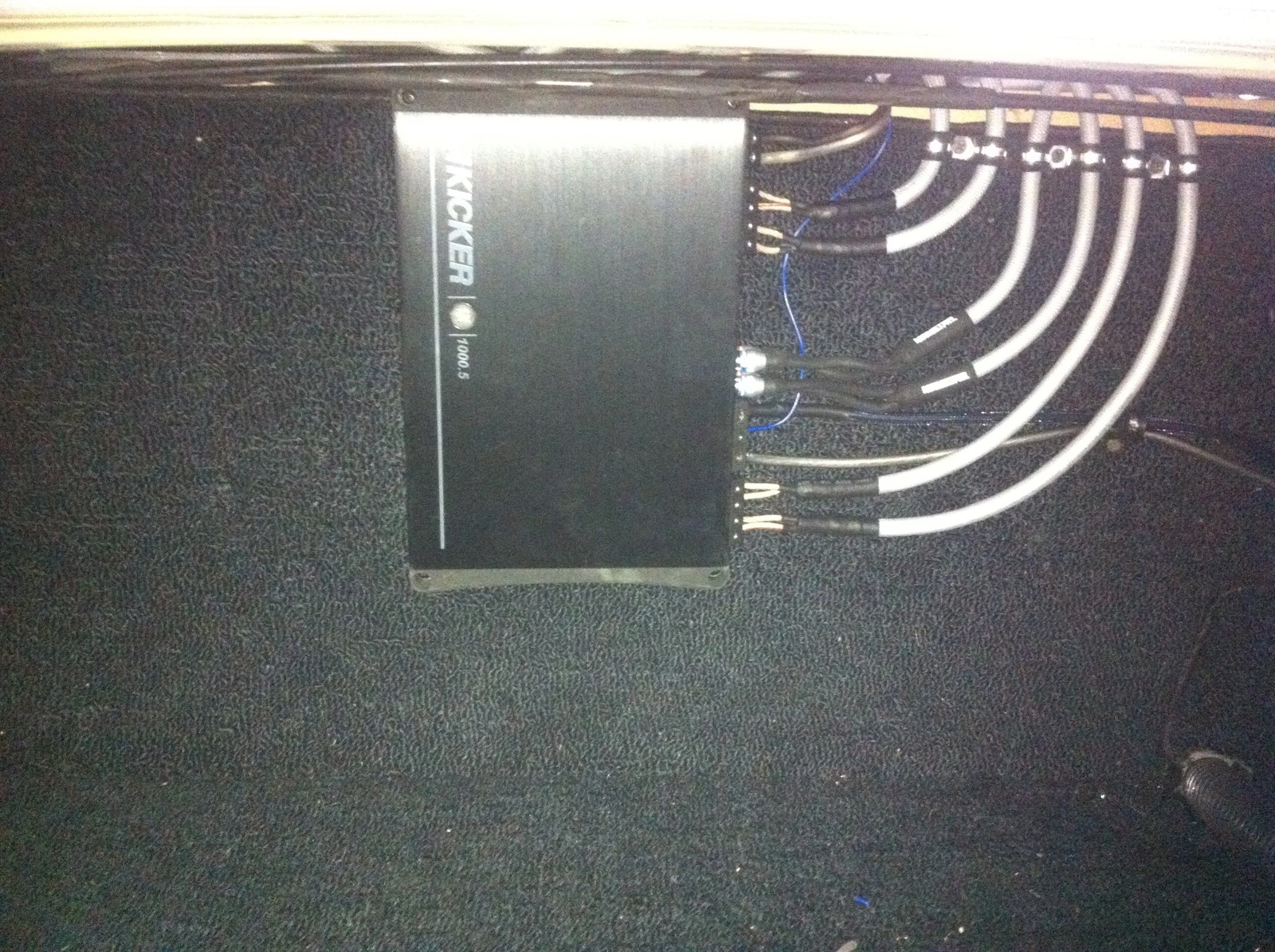

I used the coupe trunk carpet kit, built a sub box that matches the angle of the sheet metal behind the rear seat and is vertical on the rear of the box. The carpet kit is just long enough to go up the back of the box and looks pretty clean. Mounted a 10" alpine sub in the box and a 5 channel kicker amp and done. Sorry for the crappy pics...IPhone.

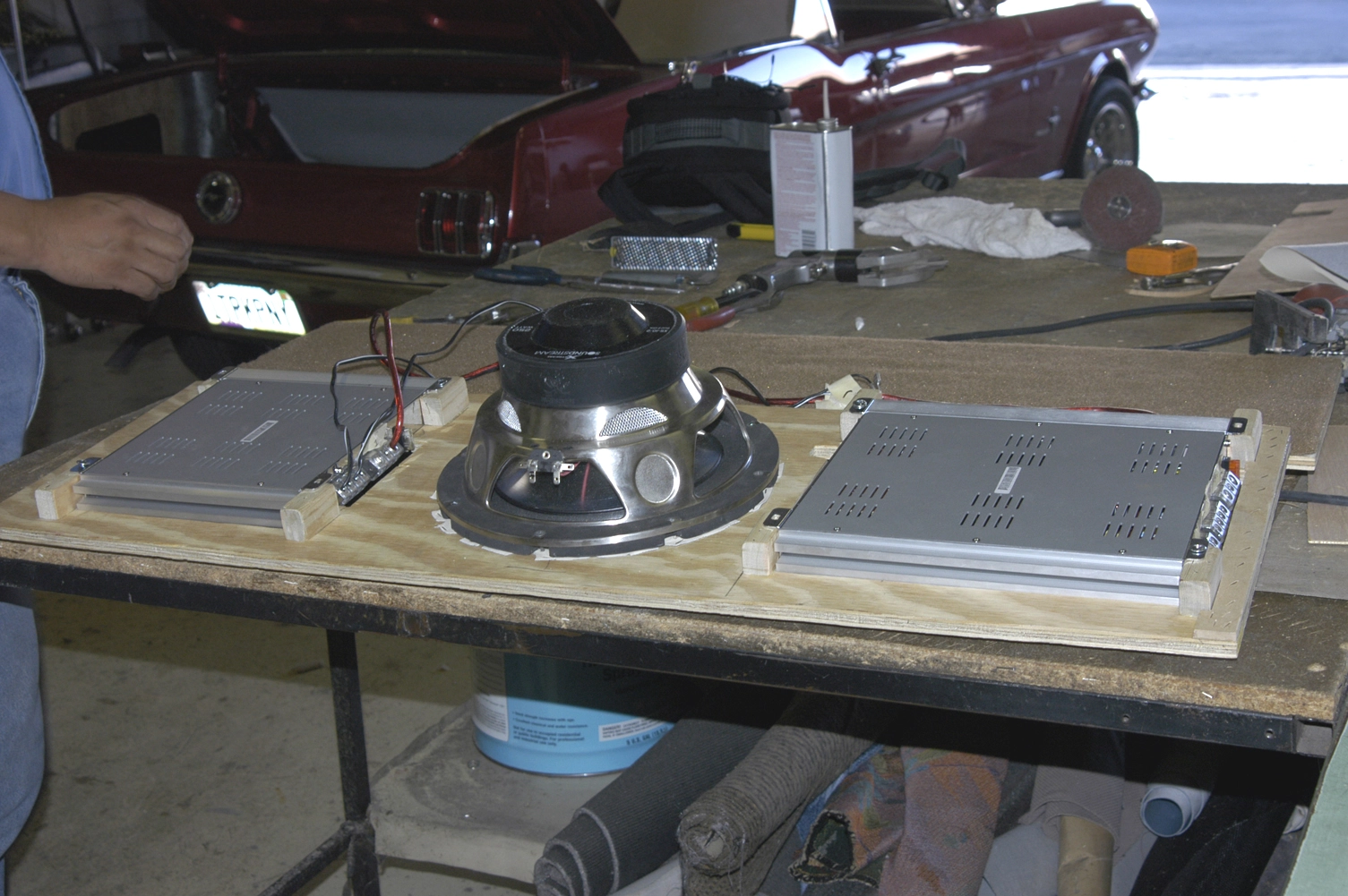

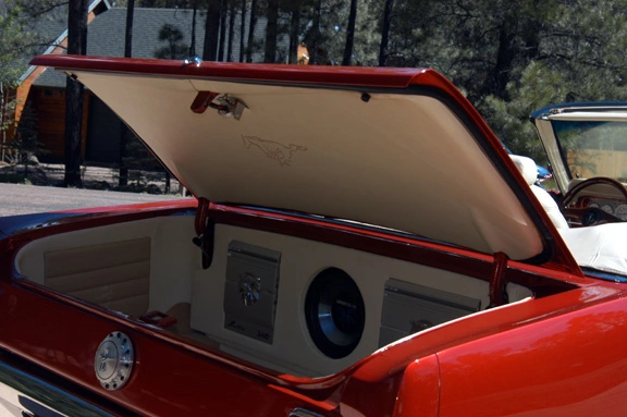

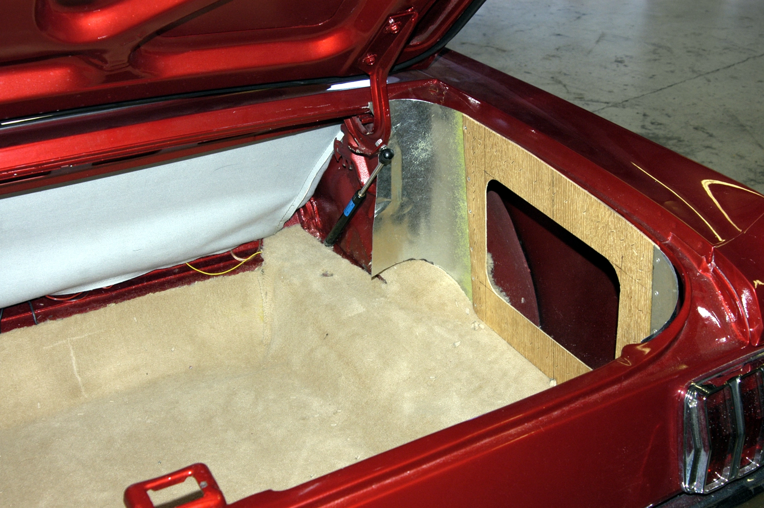

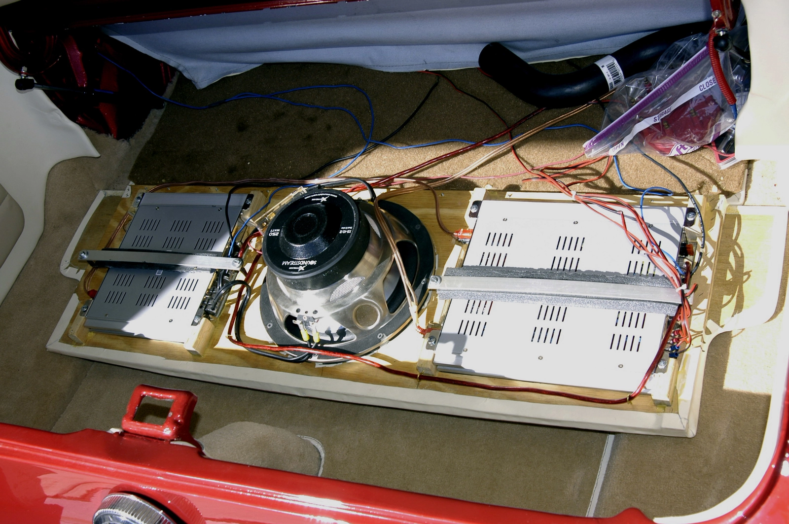

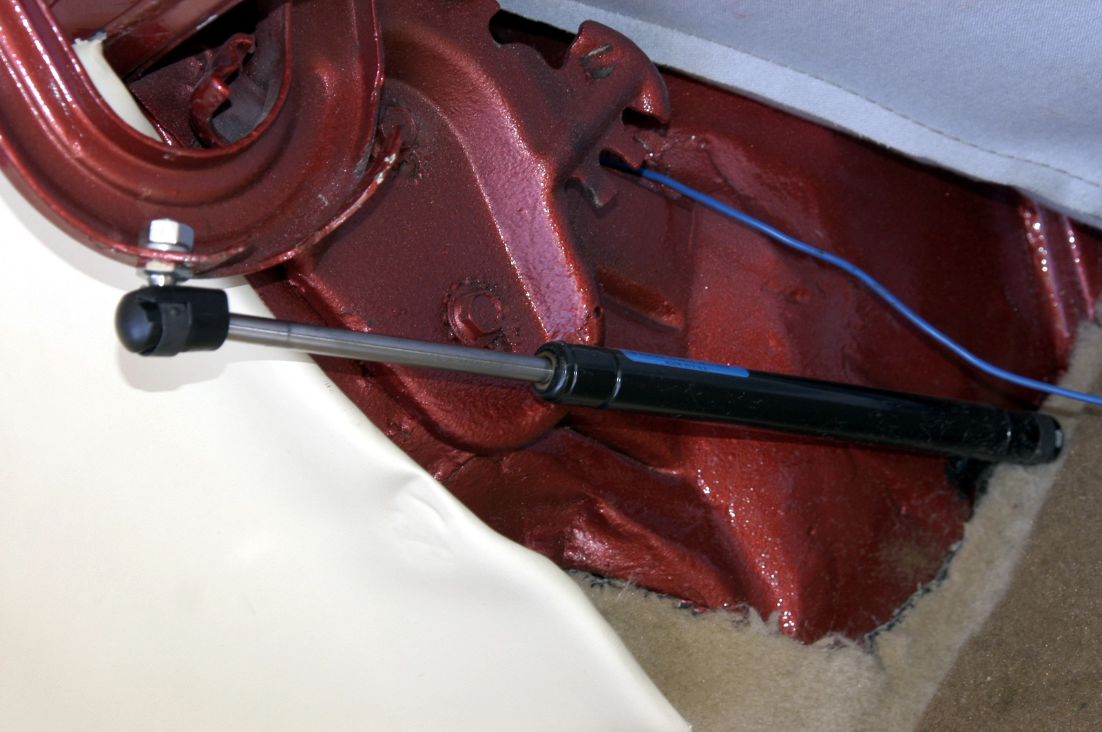

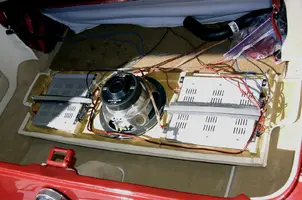

I am over the hill (67). I have 360 watts running the passenger compartment speakers and 240 watts on the sub woofer. It's not a big thumper but puts out a great sound for cruising, especially with the top down. The panels are plywood with sheet metal for the curves. Side and rear panels are fiction fit and lift out. The amp/speaker panel is hinged to the floor so it folds down for access and storage space. You have to remove the cross tortion bars that hold the trunk lid up and replace them with gas lift cylinders. See attached pictures.
