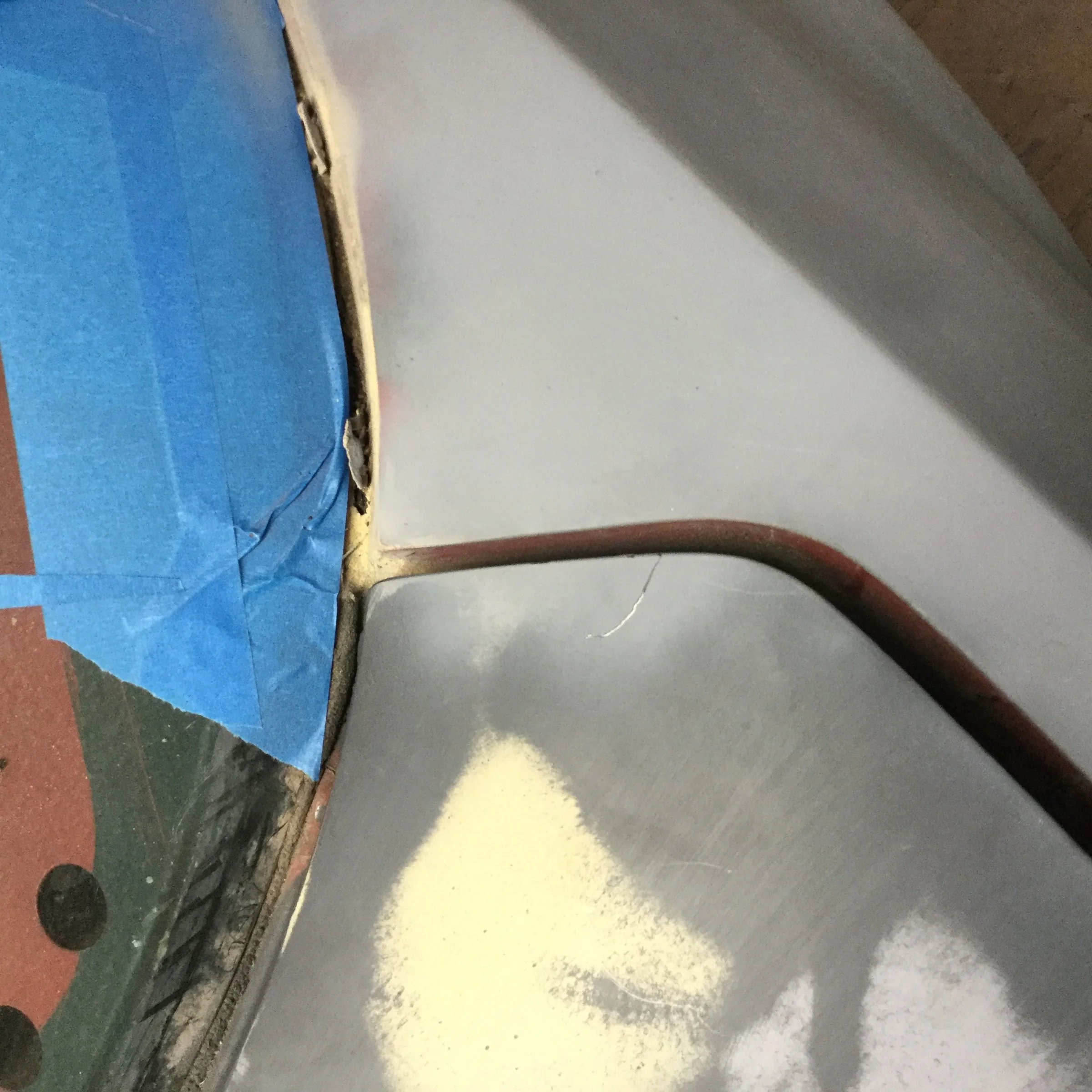

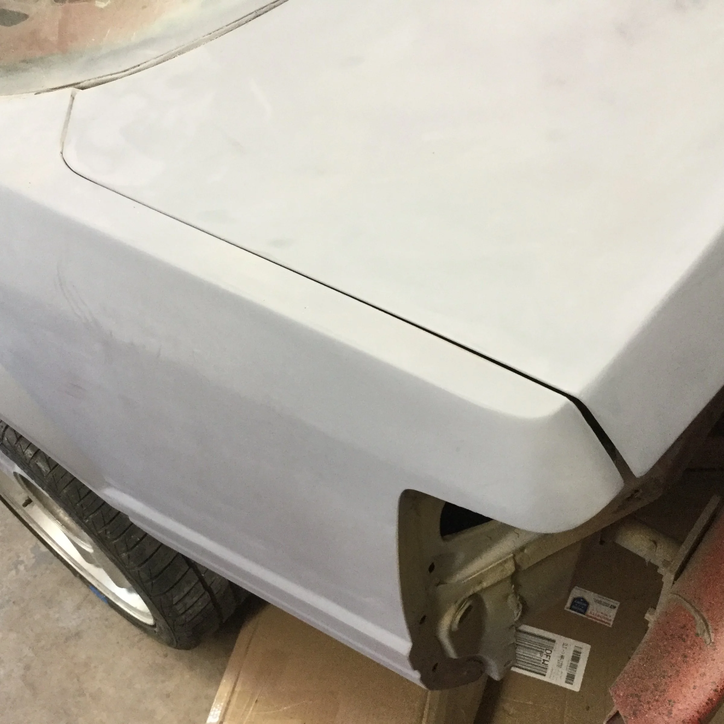

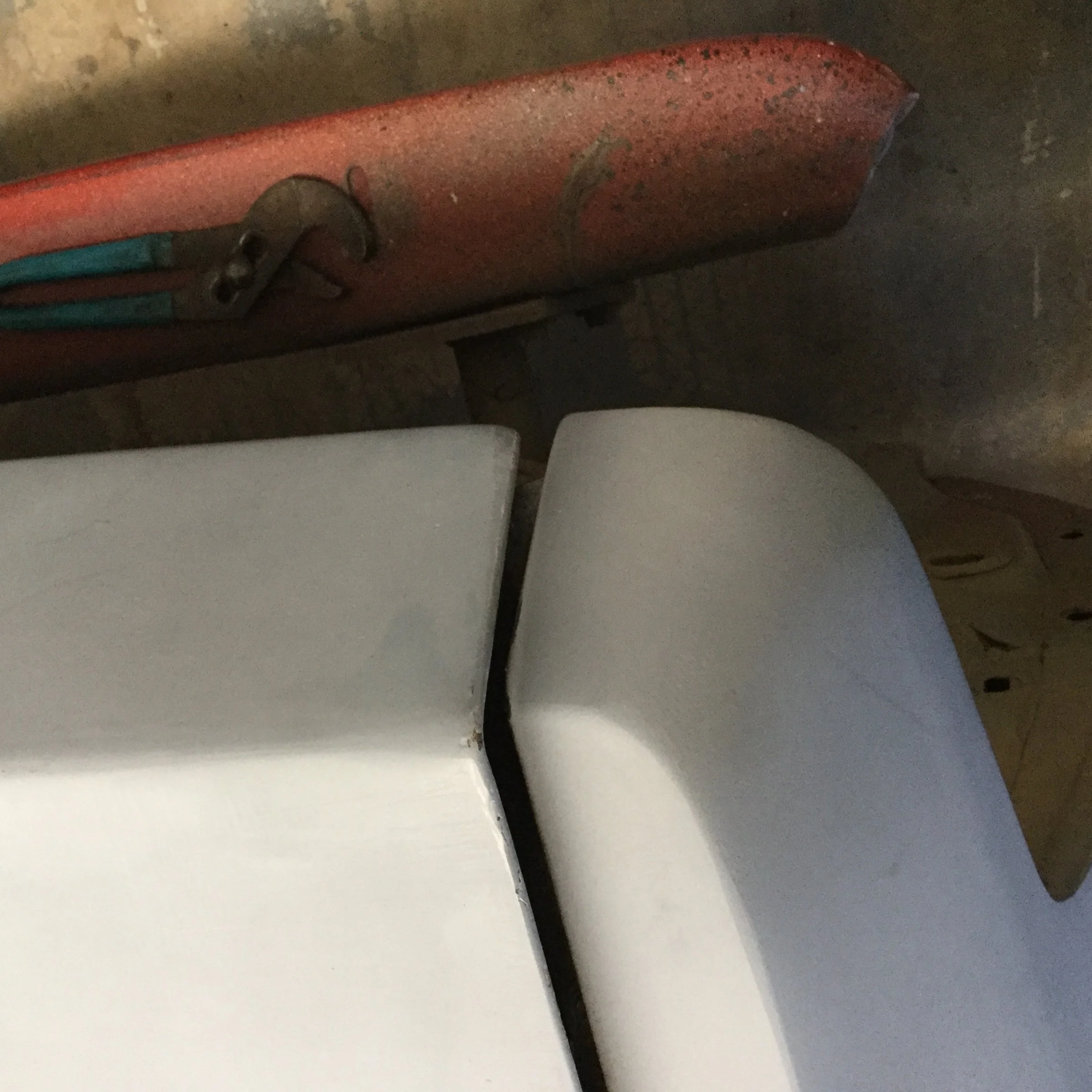

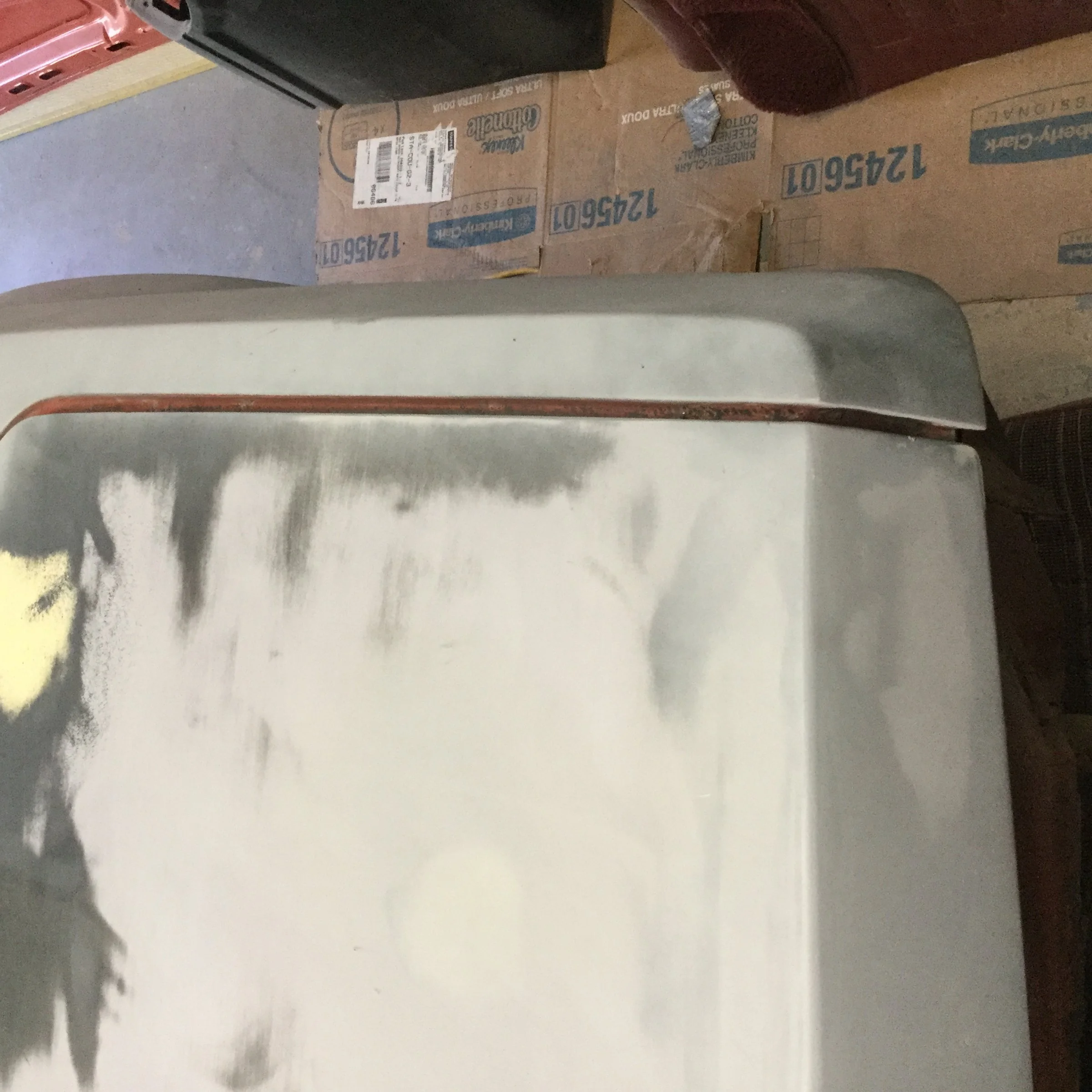

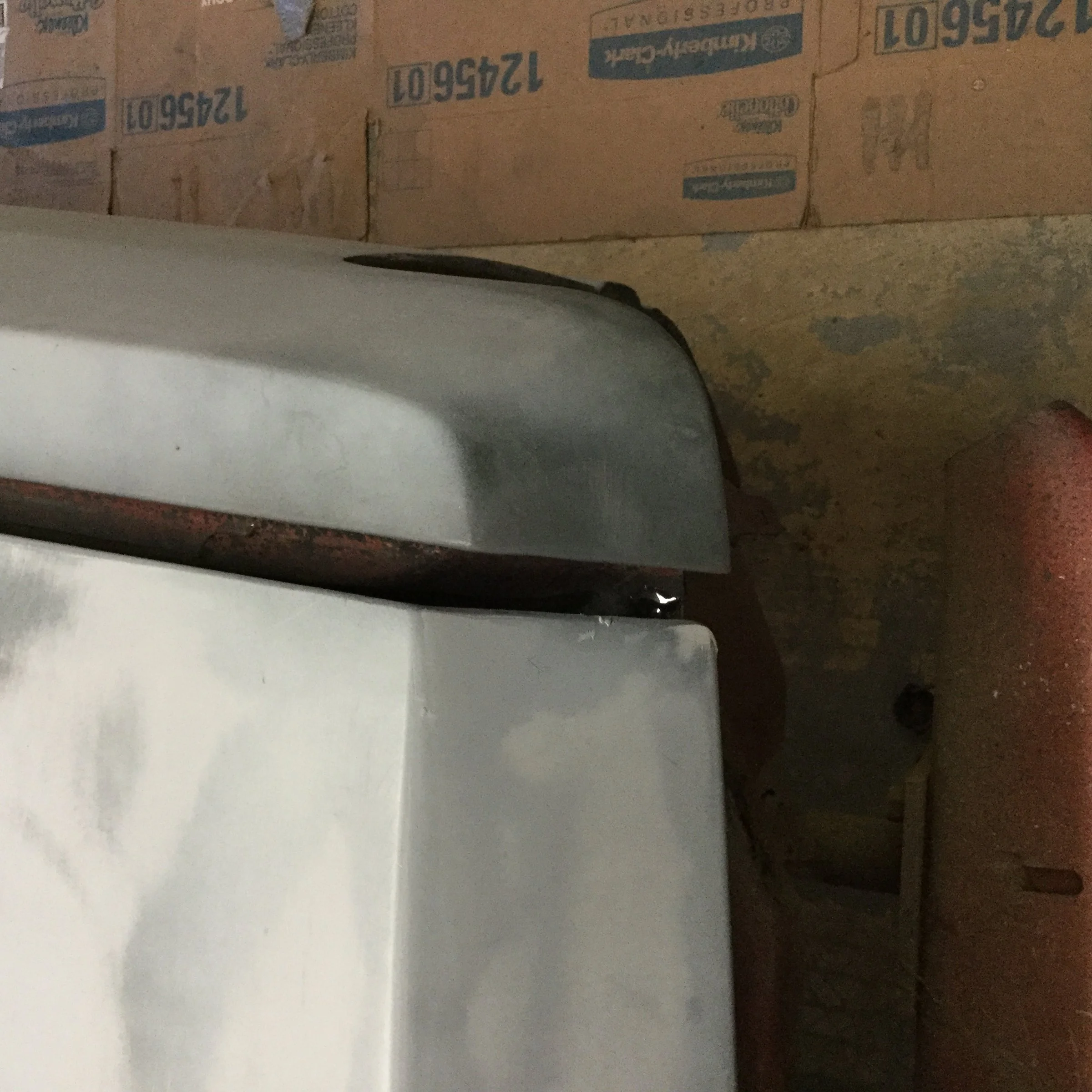

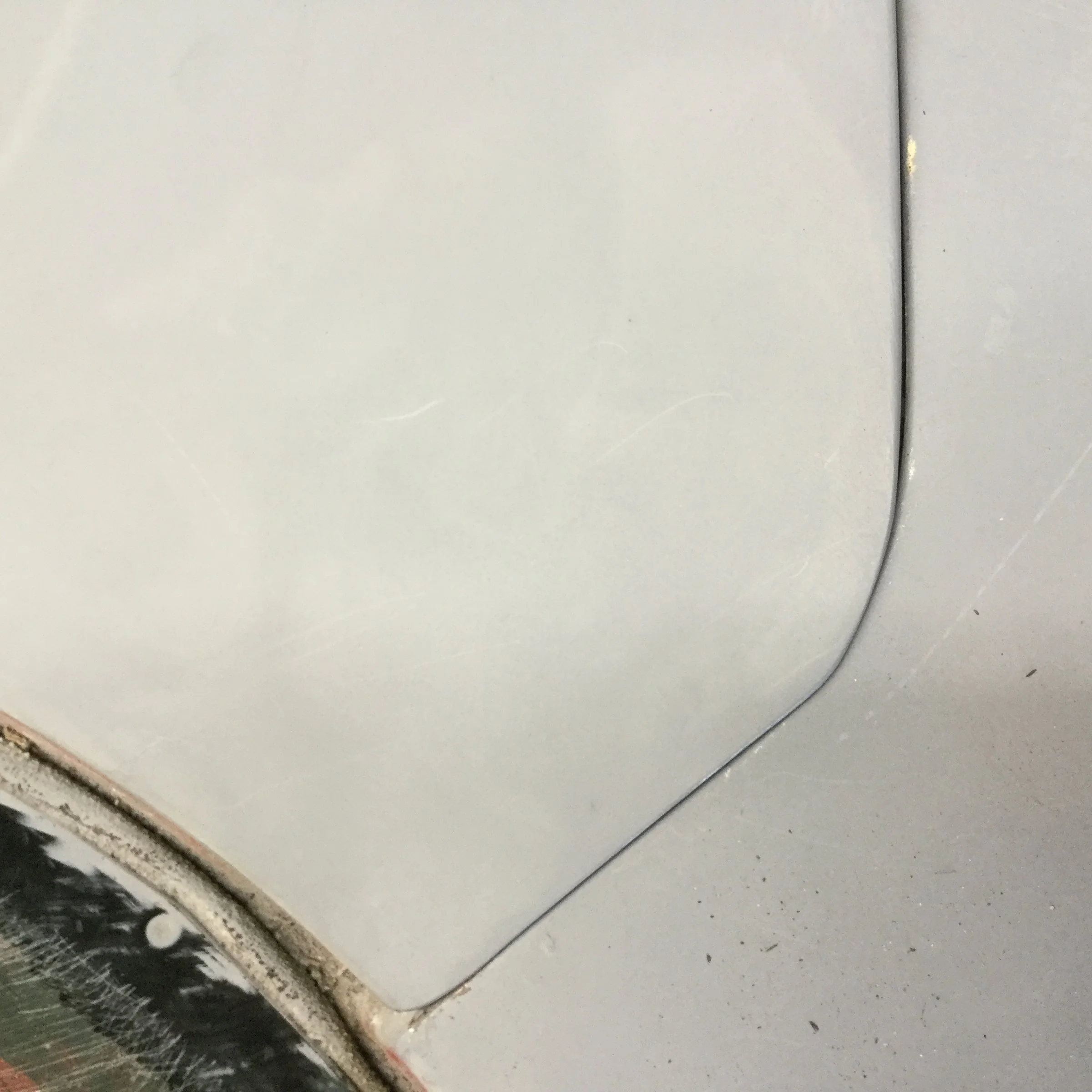

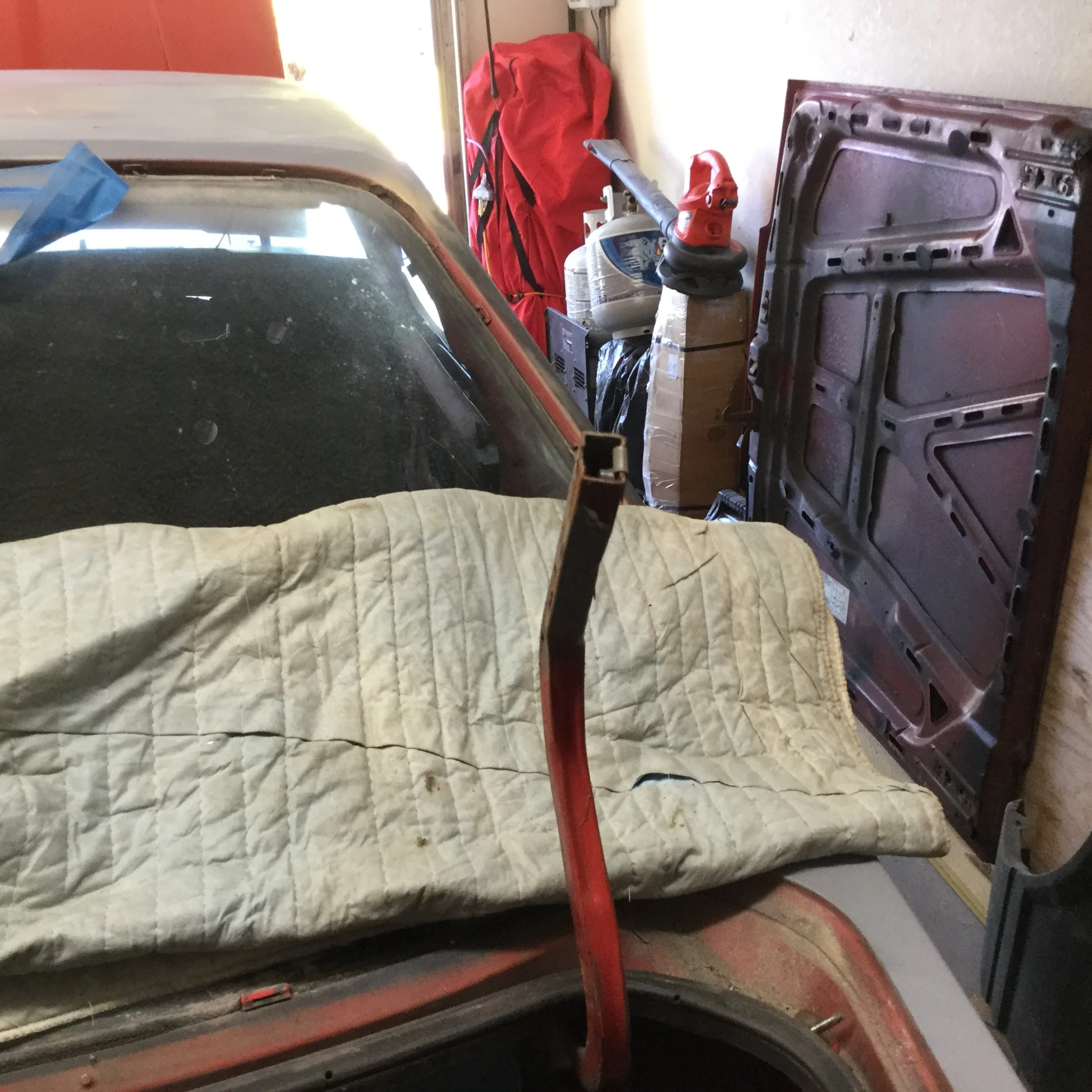

I'm just not getting anywhere. At the moment the left side is as far forward (towards the front of the car) as it will go, and the right side is as far back as it will go. The rear of the trunk lid is fairly even with the trunk line and the back of the fender, and the left side won't go far enough forward to be even, although it seems to be fairly even with the fender. Again, when I tighten the right side hinge bolts it pushes the trunk lid to the left. I guess this is due to the twist in the hinges. See photos
AAAARGH!!! This drives me insane!

Ok Jim. Obviously the adjusting won't be enough. Sorry for taking so long to get the jist of the issue.
There's not really a lot that can cause this, fact is, the hinges are it.
Did this deck lid fit at one time with the bolts tightened?
All it seems like to me is that the hinges need to be tweaked back to the right side of the vehicle.
There will be some fine tuning after you get the hinges straightened out.
Since the right hinge seems to be the main contributor to the problem, i would grab it down by the curve area as it gets close to the bracket in the body and start first with a nice steady pull toward the right quarter. See if it bends in that direction at all.
Worse case you might need to take a bfh and smack the right hinge closer to it's mounting bracket. Not overly hard, it's not that far off.
Be careful when twisting on the hinge, the spring rod could snap out. It'll smart like all hell if you get whacked by it.
Do some measuring before and after. See how far it is from the hinge to the quarter on each side. They should be fairly close to each other on measured distance.
