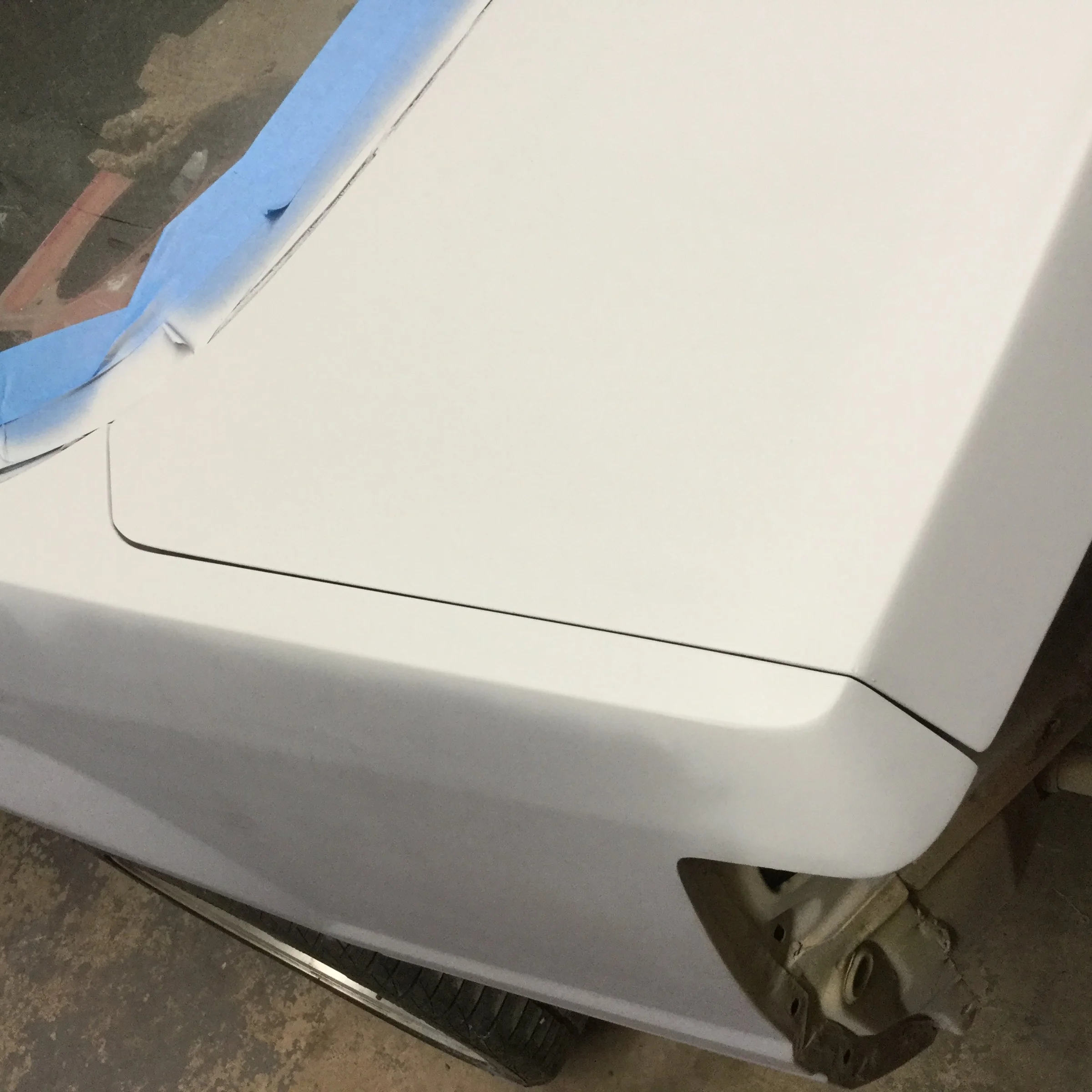

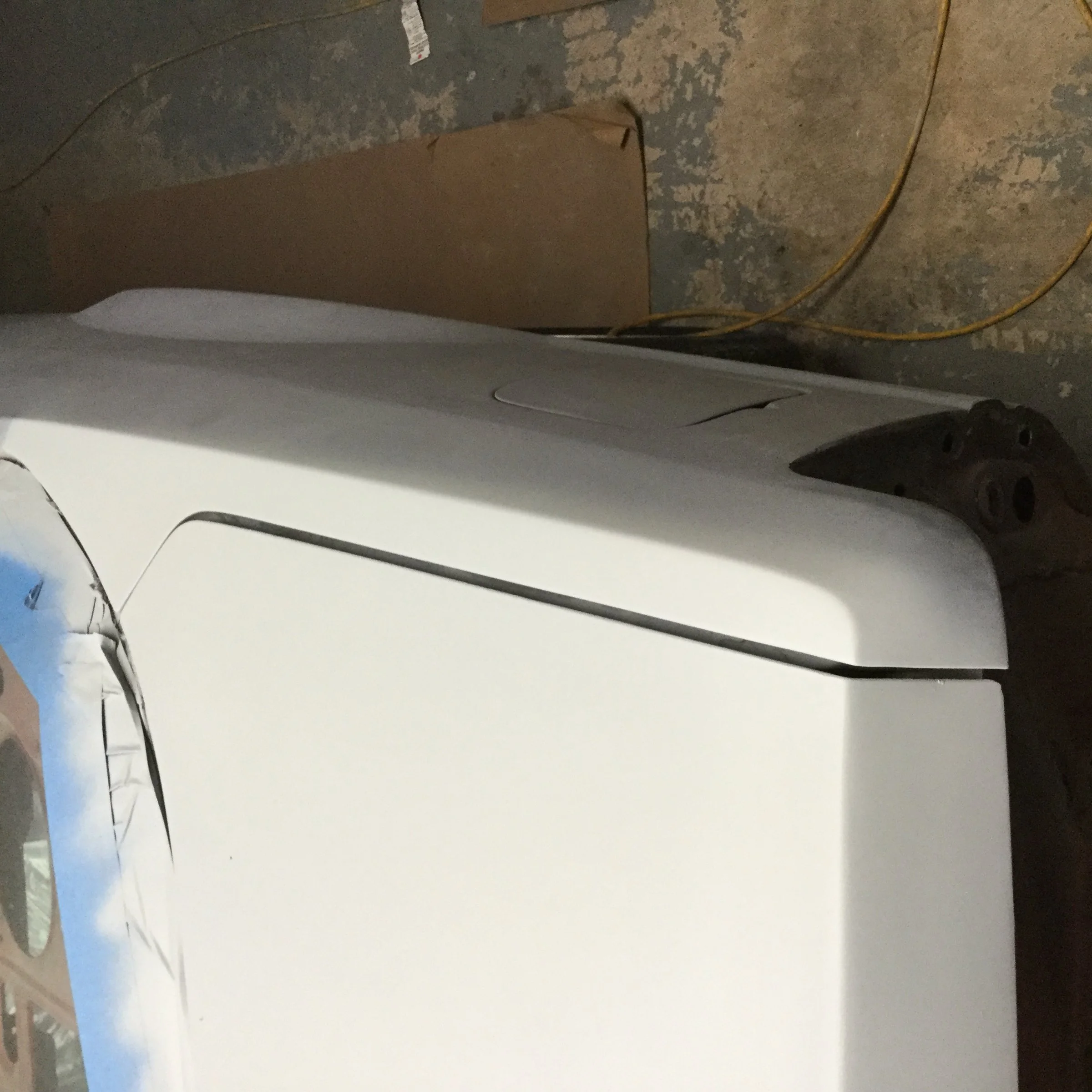

Worked on the trunk alignment a good part of the day. I'm just glad I don't do this for a living; I'd be starving and po'd. I'm okay with the results. I bent both hinges, several times actually. There's a lot of "spring" in the way these are mounted. At least it now has a gap on both sides and they're sort of even. The only thing is, I could not get the edge by the taillight to go down even with the body; it sticks up just a bit. There's really no adjustment, as it more or less just pivots on that rearmost bolt. The forward bolt (closest to the rear window) does adjust up and down quite a bit, but not the rearmost bolt. Here's how I left it. Thanks again for all those who helped
Jim

To be honest, the tolerances on these cars were crap from the factory. You are about as close as you can get. I'd put money on the frame being slightly out of whack as well.

Good work there jim, that's much better!
There might be a little twist left that you can take out by placing a 2x4 on the other side and lightly pushing down on the area that's too high. You don't want to use lots of pressure. Push a little, check it, push a little more if you need, check it, etc....
