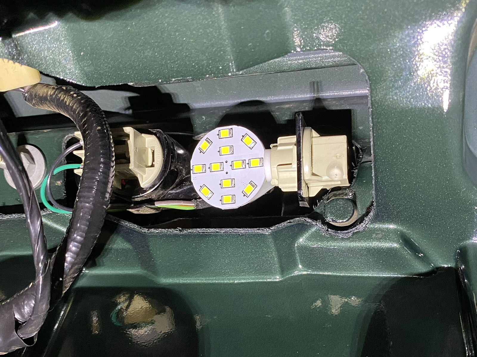

After being disappointed with w5w/194/168 wedge LED bulbs for the 921 trunk light, I bought this one and it actually fit and is actually at least as bright if not brighter than the stock 921 bulb. I went with the warm white version for personal preference to make it look close to OEM but there is a 6000K cool white version too
the flat design works well because of the way that the light is positioned in the stock socket
I did have to pinch the connectors into the plastic wedge base and it was quite fiddly to put in.
