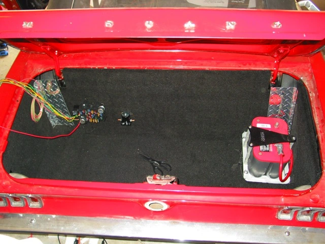

Here's a shot of my battery:

Great guys thanks. I was hoping the normal routing was into the car. I plan on leaving the sol. in its orginal location but it is very close to the powerdyne blower housing so I may end up having to move it. Now I have a problem with this gear drive starter hitting the drag link when I steer the car....:bang:
