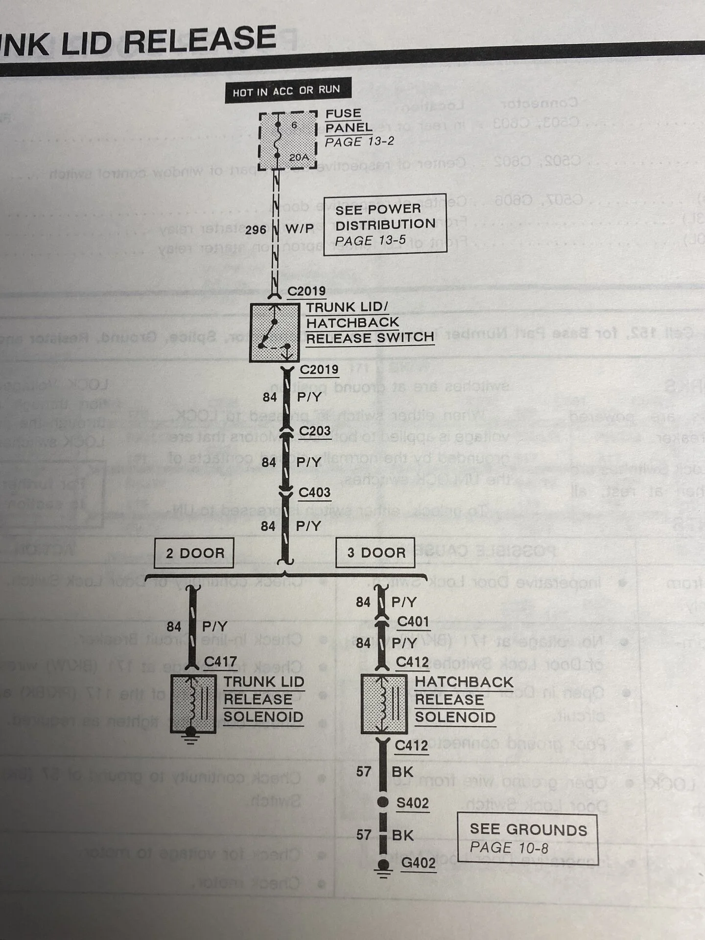

Bsimps Member Dec 27, 2019 28 9 13 Sarasota Fl Feb 18, 2021 #1 Feb 18, 2021 #1 Hello Good Friends, The remote trunk open button in the glove box in my ,91 GT doesn’t work now, any ideas to fix?
Mustang5L5 That is…until I whipped out my Bissell Mod Dude Feb 18, 2001 43,260 17,945 224 Massachusetts Feb 18, 2021 #2 Feb 18, 2021 #2 Unplug the button, and short the wires in the connector together. Does it pop? You should have 12V on the white/pink wire. Check fuse number 6. Should be a 20A fuse. Reactions: Potomus Pete and ThinBlue502
Bsimps Member Dec 27, 2019 28 9 13 Sarasota Fl Feb 19, 2021 #3 Feb 19, 2021 #3 Thank you for quick reply, checked the fuse first and there was a 15 amp instead of 20, replaced with new 20 and works great now..thanks again Reactions: Rdub6 and Potomus Pete
