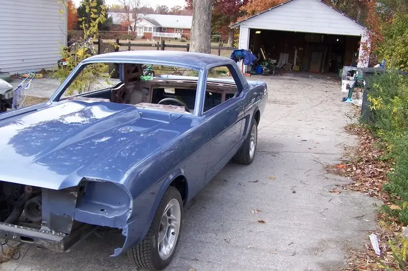

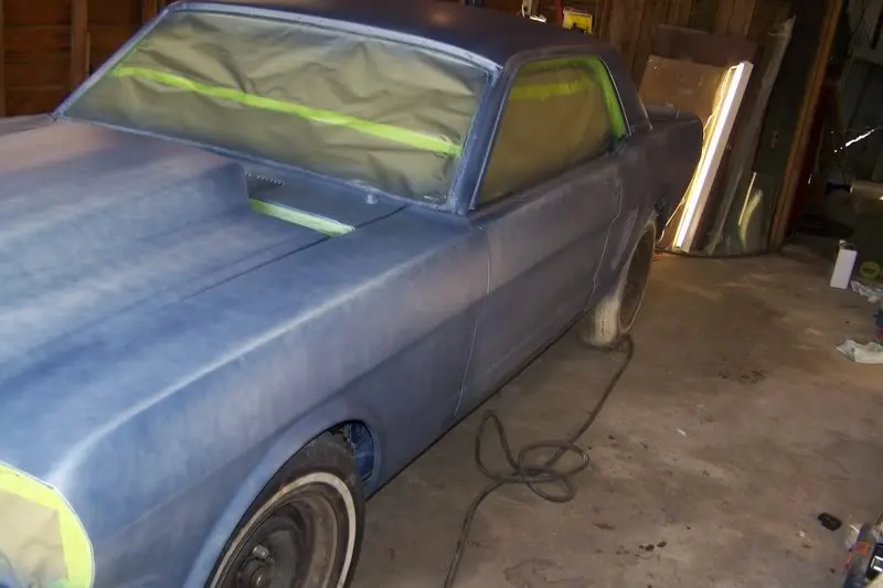

hey if i can do it then you can do it . my suggestions are as follows.
1. use quility materials
2. sand and sand and sand and when you think you are done block it again
3.take your time
4. dont do it to please anyone but yourself cause there will always be someone to pick it apart .
5. and remember if you screw it up you can always fix it
if you have any ?s feel free to send me a message or email me at [email protected].
hope this helps, dan

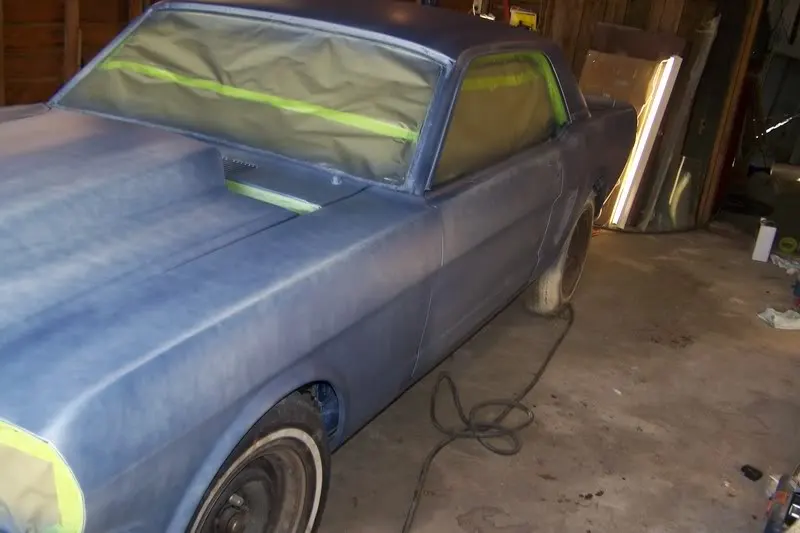

3.take your time
NICE JOB! :nice:

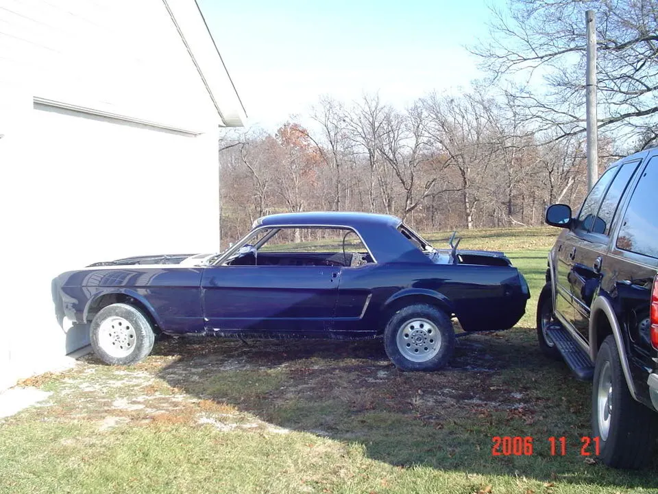

BTW, is that Brittany Blue?
hey there carfreak yea i did all the body work and paint myself i had sprayed a little single stage at work on the front of utility bodies but thats about it this was my first attempt at a full car , and a base clear oh yea and a mettalic lol.
the rodder link is a good one but also check out autobody101.com it is a awsome site. i have spent a many of hours studying the posts so that i could learn as much as possible as to how to fix any possible screw ups and yes i had a couple lol . one was a burn through during buffing. had to reshot the whole passanger side after two failed attempts blend in the s$#ew up lol.
as far as the color it is supposed to be ford light ice blue but i think they messed up on the mix but its all good cause i like this color even better :D oh and i have more pics for anyone that is interested. vinyl top and headliner will be in by weeks end woohoo then time to do some wiring. :rolleyes:

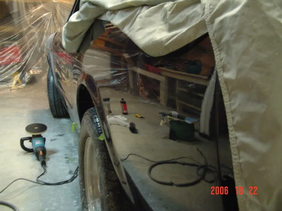

I painted my first car last year... I studied for about a year off of hotrodders.com...
PATIENCE is key. Walkaway when you're tired. I used a china gun and PPG's shopline (very inexpensive bc/cc):rolleyes:
Hank

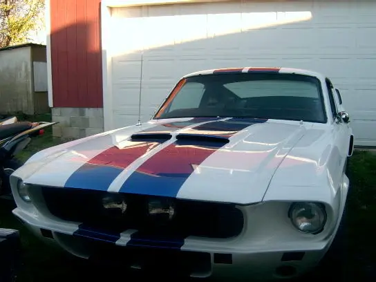

I painted my fastback a couple years ago and I can say that the best thing you can do is be patient and don't try to take any shortcuts on the prep. Everyone makes mistakes, but the trick is to not ever say "close enough". If a panel is giving you fits, seek advice, it CAN be fixed. Don't use an inch of filler to compensate for poor bodywork. If you have to, replace the door, fender, trunk or hood rather than slop on filler. Read books, watch videos and do it. If I did it, you can do it.
