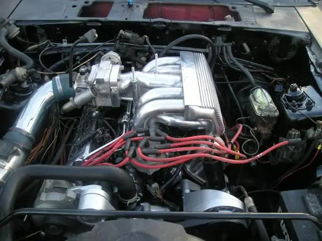

Its aluminum. you don't want to us sand paper you will scratch it use some sandind disc that have the pads it will leave it almost polished looking then you can paint it you wont see any scratches heres a picture of the one I had on mine before my systemax...... hope this helps.....

Your saying If mine is powdercoated or painted? Mine is all natural polished. No paint or powdercoated its all polished out. You dont us any grit disc they usually come in fine,medium and cooarse.Here are some pictures that im talking about,
View attachment 313424 ...if its powder coated you might us some of the sanding disc with grit on it i would get the highest grit posible so you won't leave scratches..but it will be hard to get betten the runners
hope it helps if you need help let me know.
