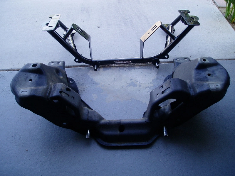

I'm running a PA Racing Tubular K-member with stock a-arms and Eibach Pro-Kit spings on my Daily Driver. Handles just as good as the stock K.
I get a little more engine vibration from the stiffness of the PA K.
Overall I think its a good product.
Here's a link on how I did the install
http://stangfreak.com/content/index.php?option=com_content&task=view&id=52&Itemid=31

You were able to reuse your a arms and springs? Cool glad PA racing is just up the road from me. :D
