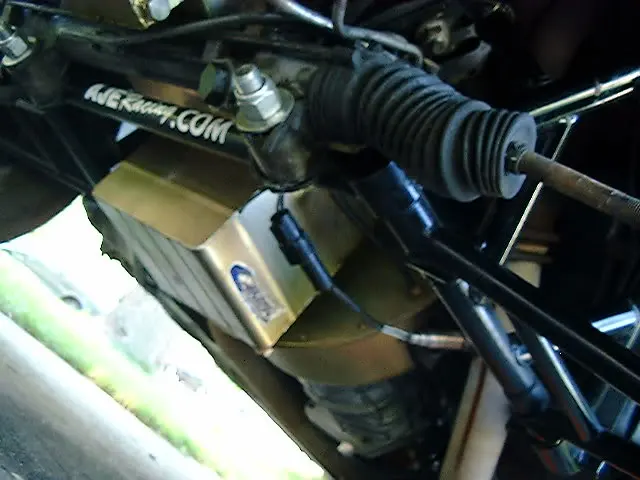

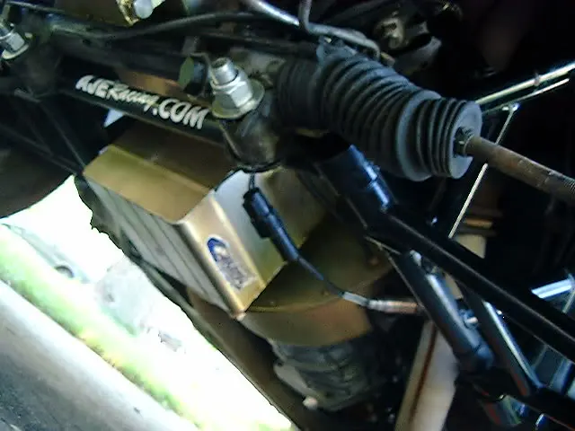

dunno about the weight savings other than i know it was worth it. from having to drag the stocker out with arm, struts, ....everything still atached. i just took out the eight bolts and draged it across the floor. wasn't too fun. i mainly like the EXTRA room underneath to work on whatever. there is SO much i love it.
here is a crappy pic of it.

I ordered the GP unit. MuscleMotorsports said they were having quality issues with them and send my the GMS unit. Heavier than other units and such but much beefier. Maby one day I'll trade out. The GMS unit is expensive, I got it for a very cheap price.

It still dropped over 23bs of the front end not including the weight reduction of the coi overs. Wheels are forward more though. Cleans up the engine bay a lot.
