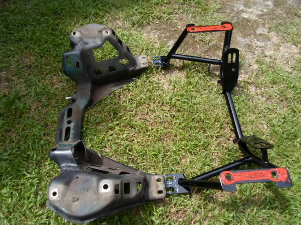

Tubular K member
I changed to a UPR K Member the weight is about 10 kilos and the Original is 25 kilos .... also Tubular A arms and coilovers.. but dont remember how much less weight...so just the K Mamber saved 33 lbs of weight...
