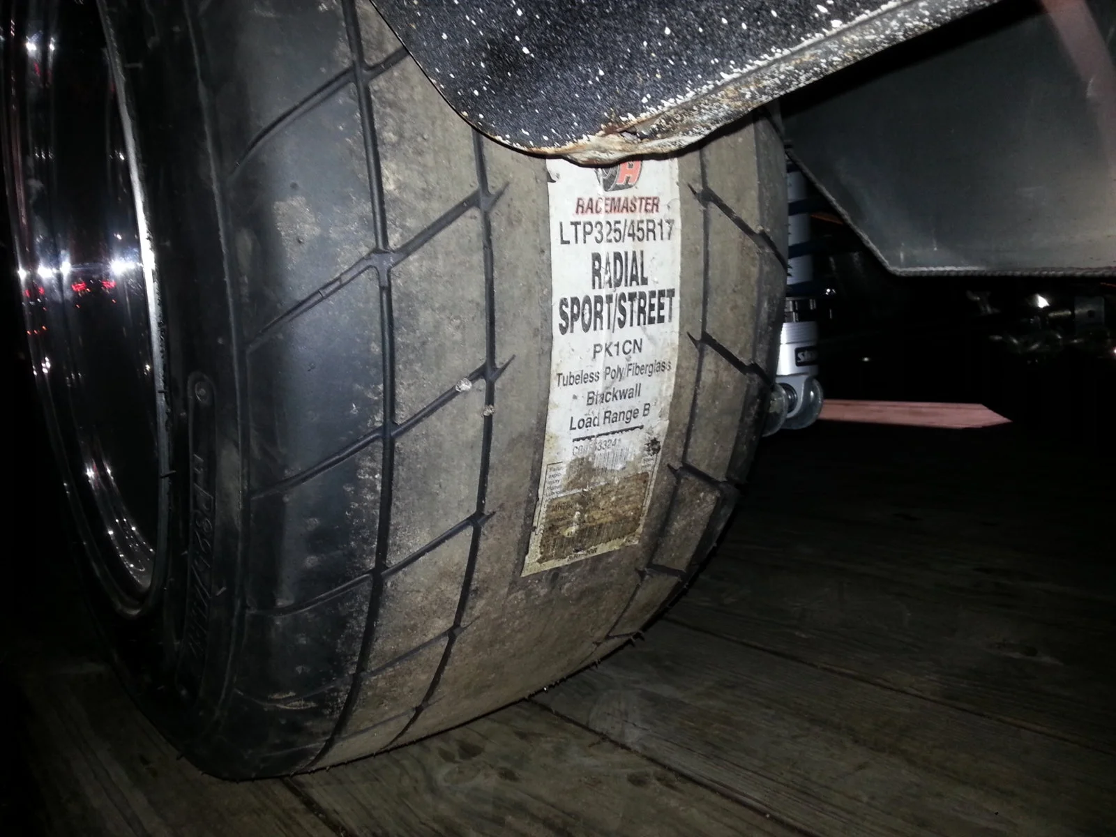

I would probably spend that money on the ass end of that thing even it's to invest in a better set of tires (or more of them since what you (OP) want will wear fast).
