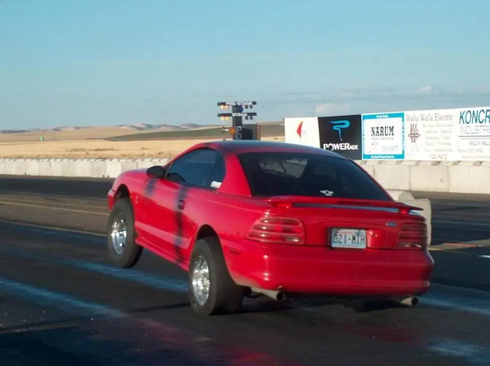

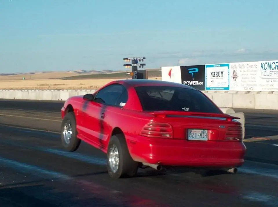

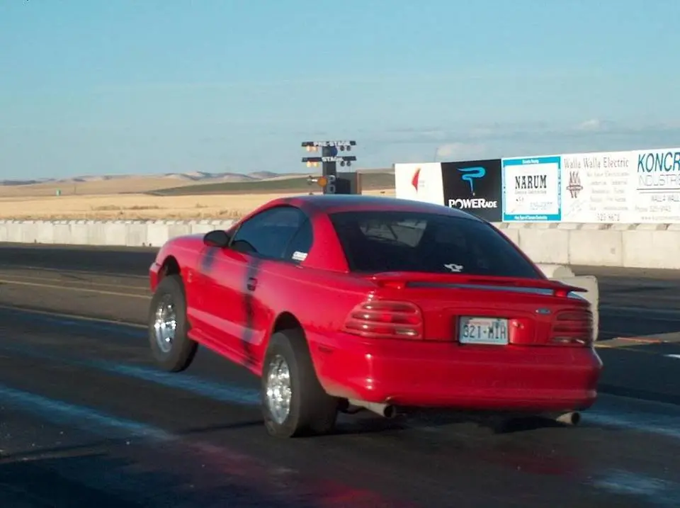

They come with several spacers that go around your CC plates. I removed all of the spacers and put them on the bottom of the CC Plates. This makes the struts as long as possible. This will give you the most travel you can have before the car tries to lift the front tires. :nice:
For some reason I want to have a video of my car pulling the front tires. I have a vid where you can see the front tires come off the ground for a split second but I want to pull them a little bit higher.
I don't have vids of mine but I have pics! :nice:
