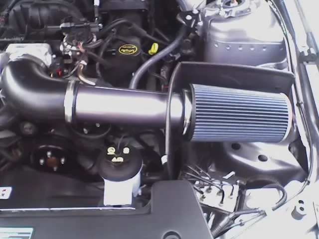

Yep big difference in the response you get with xcal. Many deals out there so check um out. I got a Xcal 2 and DeMoulet CAI for $525 painted to match my car, check um out.
