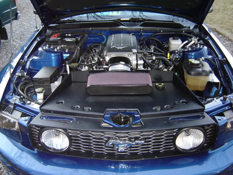

So the true difference between the factory located CAI and a ram air system will be in the real world when the hoods are closed and not on the dyno. Thus making it much more difficult to test for. Once I get the '08 Bullitt grill, my ram air setup should be a bit more effective as I will be elimintaing the fogs in front of each of the side inlet holes:D
