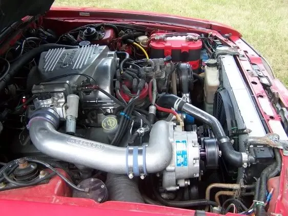

alot of minor mods heres a pic... basically stock!
