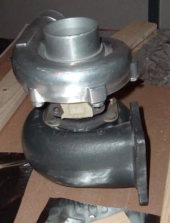

LOL this came yesterday.
I should have my complete kit sitting in front of me by next week and I'm trying to have it all done in a few weeks.

I'm not afraid to admit that I am a novice to the turbo world and I'm learning as I go.
I bought that PTK set-up off of TM and it's a PTK intercooled with a T-66.
The tial wastegate has a 9# spring and I plan to add a boost controller. I'm not sure about the housing and I still have no clue about those #'s you guys are talking about.
All I know is I'm going turbo in a week and I'll add as I go along and see more stuff I can get for it. I just want it in first and of course to bling then I'll start modding it once I have the 357 ready to go in. I'll prob have it all hot coated again since PTK offers a lifetime warranty on it.
