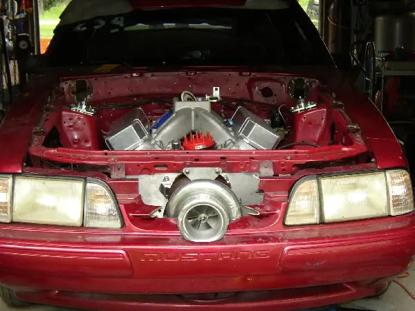

Hello all, I am new to this forum and have had some friends tell me about the great help they have gotten. Now I am here for a little help myself. Im on my way to building my 408 stroker for my 1993 notch. My goals for the car is to keep it streetable with a mild track use. im going with a shortblock from cncmotorsports.com (Dart block) with a -28cc dish on the pistons . And going with a set of AFR 225s witha 72cc chamber and it wil put the compression ratio at 8.8 to 1. And of course im going with gapless rings and head studs etc. And from what ive read i think im going to go with the trickflow box upper and lower intake or possible a custom hogan intake if i ever decide to fork up the money for it haha. But what I was wondering is what kind of turbo i should go with. Id love to throw a 101mm on there. But some would say thats a little overkill for a 408. Any help would be great or if you have any concerns about my build i would like to hear them aswell. Thanks !
