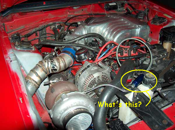

Didnt feel like reviving my old thread so I'm starting a new one.
Got pretty much all of my welding done, just need to weld on a pipe for my wastegate and one for my BOV and the kit should be complete besides finishing up the exhaust. Hope to have it running sometime soon as in maybe this weekend which I dont see why I couldnt (weather permitting) Anyways I'll shutup and heres a few pic's.
Angle of the front
Straight shot
Crossovers

:nice: awesome. some questions:
how did you connect the oil return line to the pan?
do you plan on painting it?
what kind of filter is that on the compressor inlet?
what does "breaking up into boost" mean? pinging?

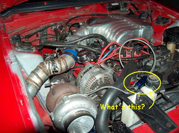

what is that blue thing?
it looks like your old pics go away. if you want, i can host them on my site so they stay around longer ... let me know
