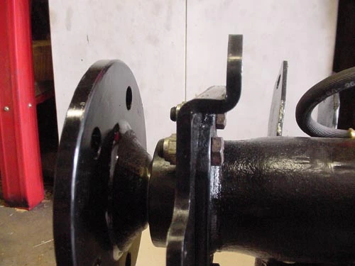

I'm going to put a TC rear in my car probably later this week after my new T5 shows up. What I did though is convert the TC rear to the stock length of the Mustang. I got to measuring and discovered that the housing is the same dimension as the Mustang housing but the axles are 3/4" longer per side to accomodate the antilock brakes exciter rings. I had a pair of 4 lug Mustang axles left over from when I converted my 86 to 5 lug so I did a test fit and found that the bearing surface on the axle ends up in the right place so no problems there. The only issue is that now the calipers are too far out to fit the rotors. I found out after I did the conversion that you can buy brackets that work with the TC brakes but they cost about $100. What I did was to cut off one of the 3 mounting bolt ears so that the bracket would go around the housing behind the flange then I made spacers and bolted it on with the remaining 2 holes and welded it to the housing for good measure. I dont have it in the car yet but I dont see any reason that it wont work. It will work as is with stock wheels but I have 9" Cobra R's which is why I shortened it. I got the 3.73 rear out of an automatic car so it should work well with the 2.95 first gear T5 I just ordered. For the brakes I found a '93 Cobra master at my local O'Riley for $60. It is a brand new unit and came with the resivior. Im getting the rear brake line adaptors and 2 port conversion from Matt. Rather than reusing metal line from the Mustang I am just going to bend up a new one to fit the TC rear. On a side note, I paid $125 for my complete rear from a locak junkyard and they pulled it. I did have to replace the rotors and pads though.

Dude, NorthRaceCar brackets! that is all I have to say about that!
